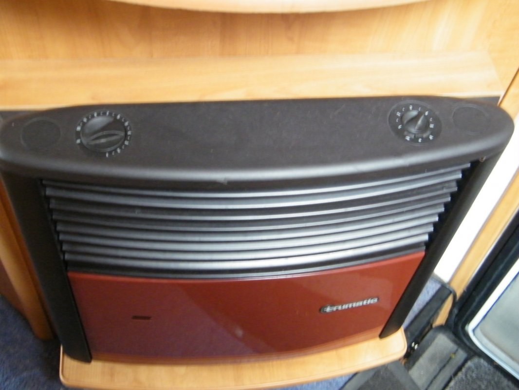

Hi,
Does anyone have a manual for the following version of the Truma ultraheat or alternatively can explain the controls?

The left one regulates the thermostat and is also a push down to ignite. It may be piezo or may be battery.
The right one is bottom switch is manual/off/auto for fan speed, with the dial above regulating manual fan speed.
I think! (y)

Almost the same as mine except mine has an ignitor button on the left.
The left one is thermostat for gas and right one is fan.
A is auto
The sort of moon thing is manual and the middle one is fan off.
Electric heating works from a round knob on the wall somewhere.
