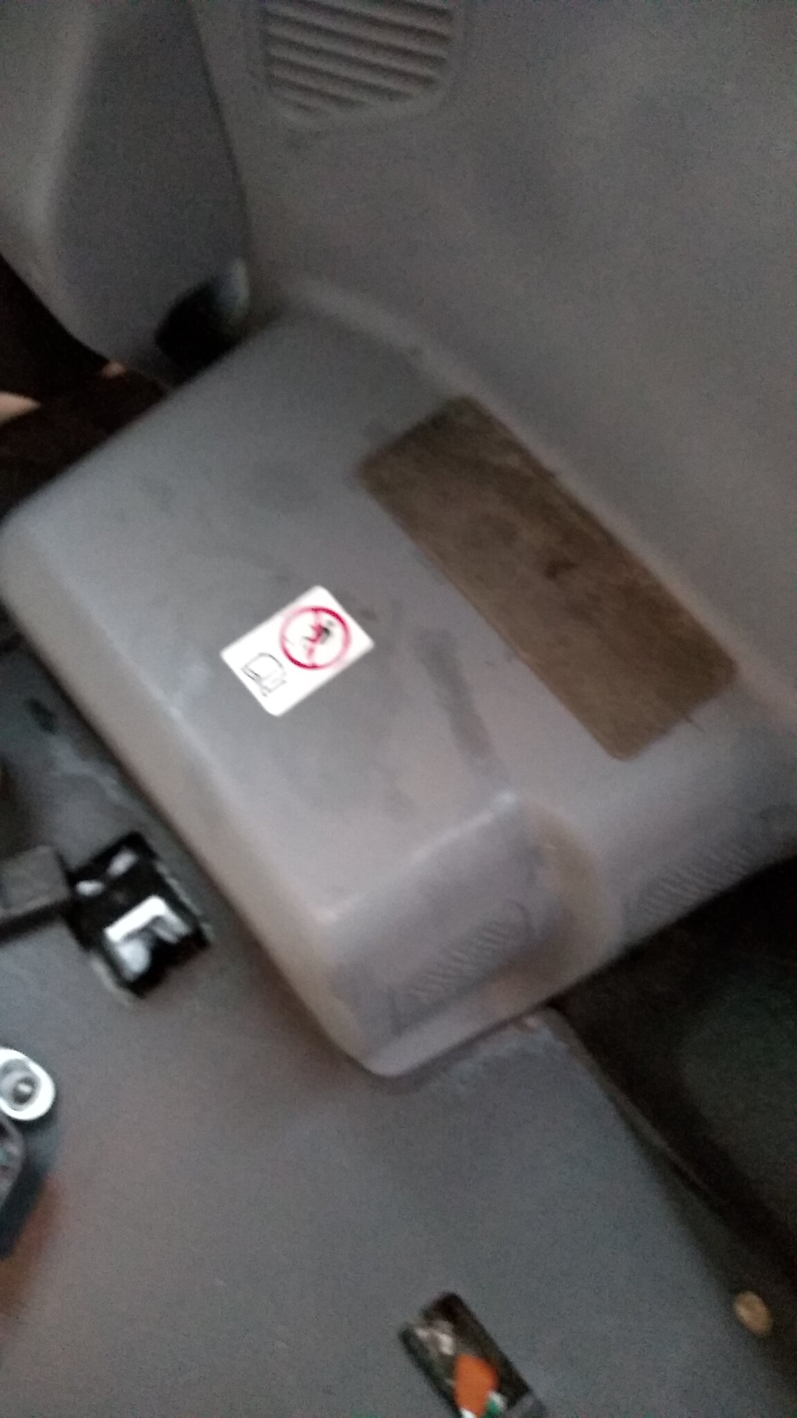

What's the box at the rear left with vents in see pic????

Looks good James. as you know i removed the plastic and gained another couple of inches even after boxing in, but I love the creative use of the cup holders. Your 'box with grills' is part of the rear air conditioning unit, there should be vents above, in the lining probably, mine were set into shelves. If you look under the floor pan you'll see lots of normally useful space used by pipes and a heat exchanger.

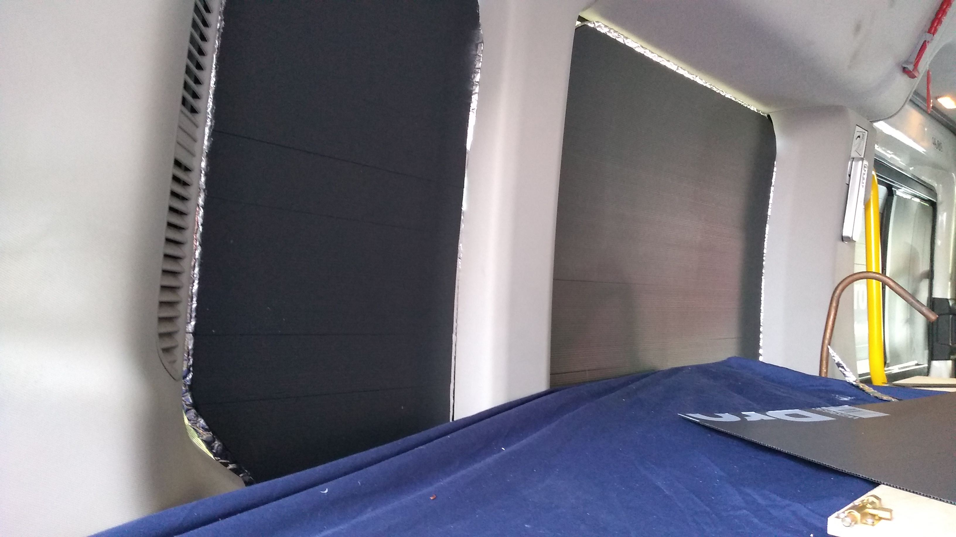

New window covers cheap as chips corrugated plastic covered with foil insulation works a treat just as good as the posh covers I have for the cab!
Started varnishing boy I hate painting.
Cheers James

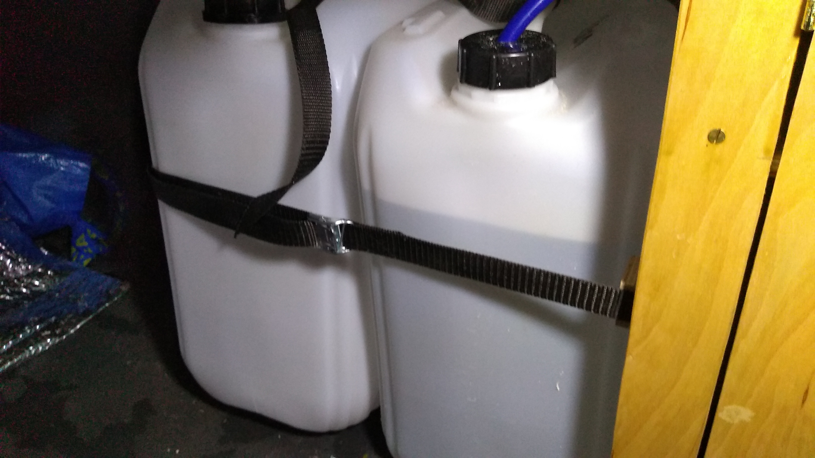

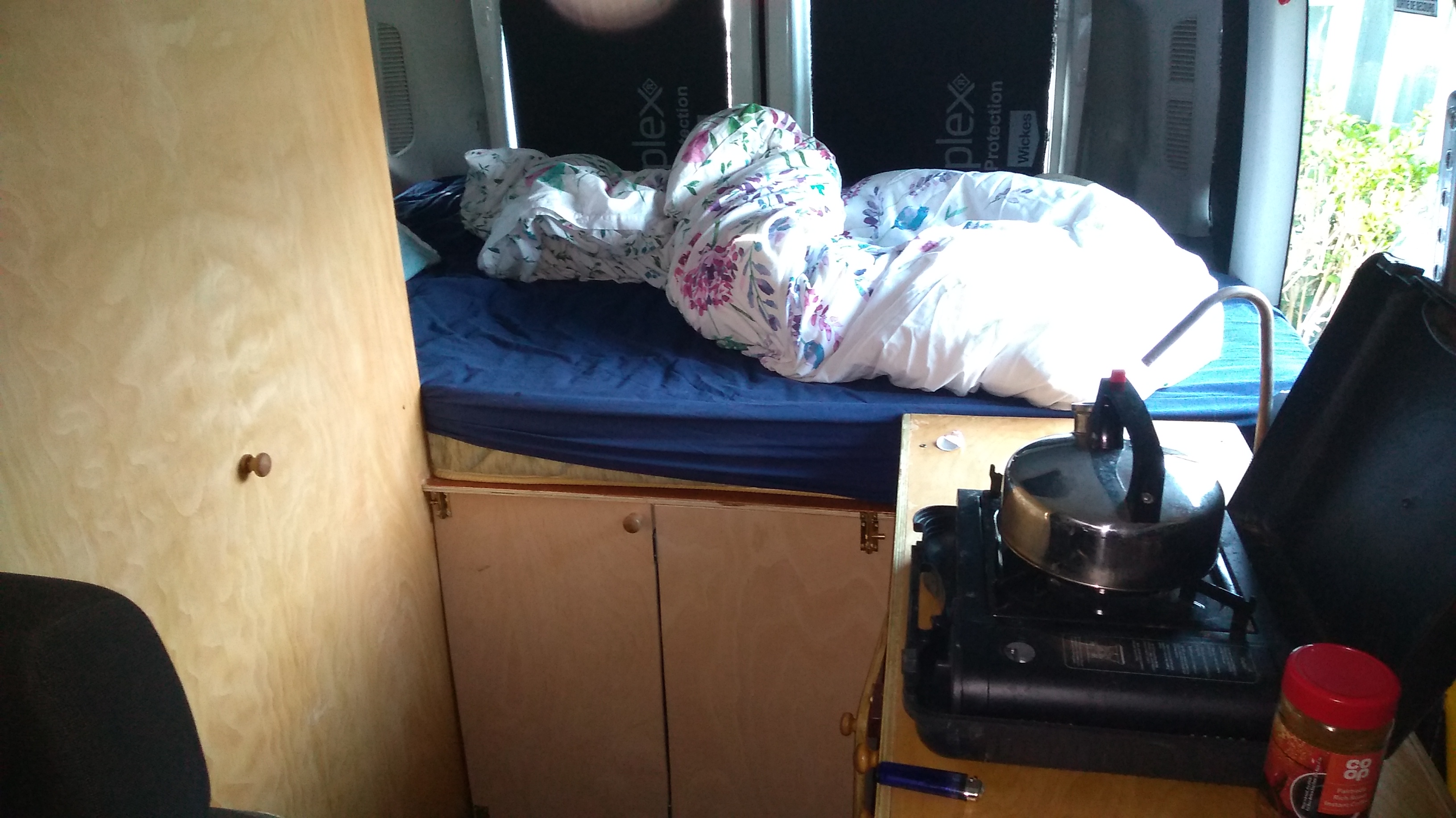

Now that the vans back up to full health following its dpf constipation!!
I decided to put the tap and sink I brought in.
Also a strap around the water bottles. I might put some scrap 2x2 on the back of the kitchen cabinet to locate it more positively....
Cheers James
