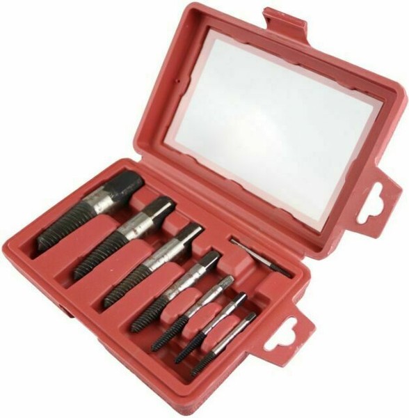

I’ll try the stud remover when we’re home

My first choice given the location would be to use a stud extractor, less chance of collateral damage.
