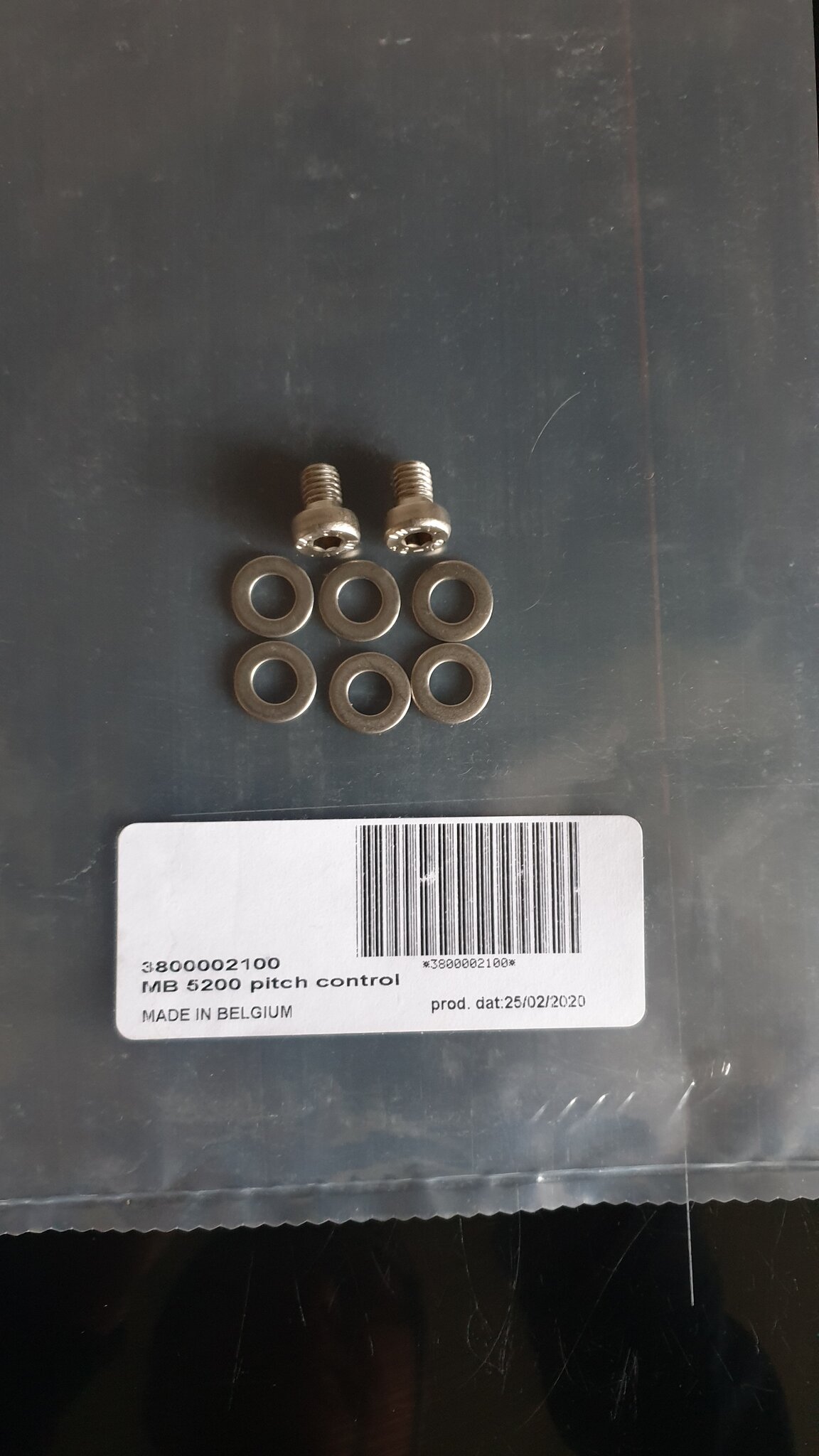

Your awning should've come with a small plastic package containing short allen bolts and 4 washers. These can be used to alter the height of the awning as it comes out of the housing. There are instructions in the package clearly showing what to do. Basically the awning angle when leaving the housing can be adjusted giving three different angles, by using one, two or no washers.
Mine were included with all of the bumf you normally get with the motorhome. If yours isn't in with it all, I'm sure you'll be able to just buy the bolts and washers. I think they're M6x12, but I'll check tomorrow. If you want me to photograph/measure them let me know.
Good job I checked. M 8 x 10mm. Photos below showing all you need including Thule part number. You could source the parts elsewhere. Washers are 1.5mm thick which is probably important to get the angles right.
