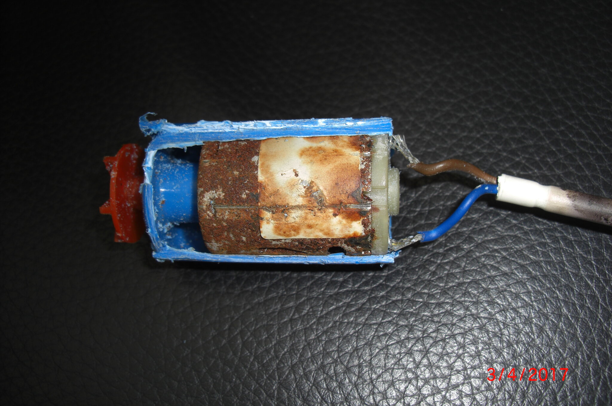

My son's 5 years old pump (in the cistern) stopped working. After fitting a new one (simple ten minute job) and purely out of interest I cut the old one open...........rusted solid.
Had to free impeller on pump in cistern on my 745 regards there is instructions on utube how to do it
