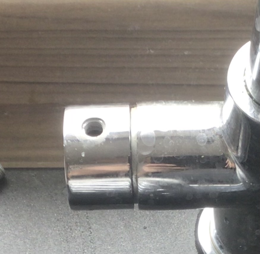

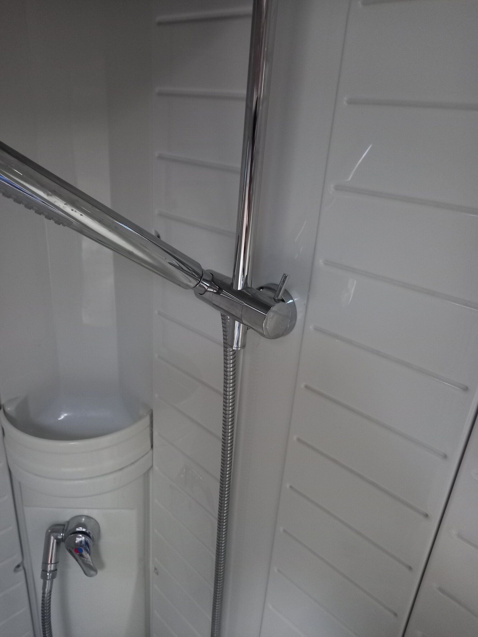

Does anyone know how to make the right hand knob grip the pole to stop the shower head slipping down? Cant see any obvious way of making it tighter.

Try unscrewing the short handle,you may then be able to remove the end and reseat it on the shaft at a different angle. I know this is a tap but you get the idea.
If you take the shower arm and head off the holder, spin the holder around, you should see a Philips head screw. Give that a tighten (hot too much or you could break the plastic holder) and it should hold.
We have to do this every 3 or 4 weeks depending on the amount of travelling we do. I did take it out of its holder, but it just moves and bashes when on the floor.

Thanks - tried that but it doesnt make a difference on ours.
