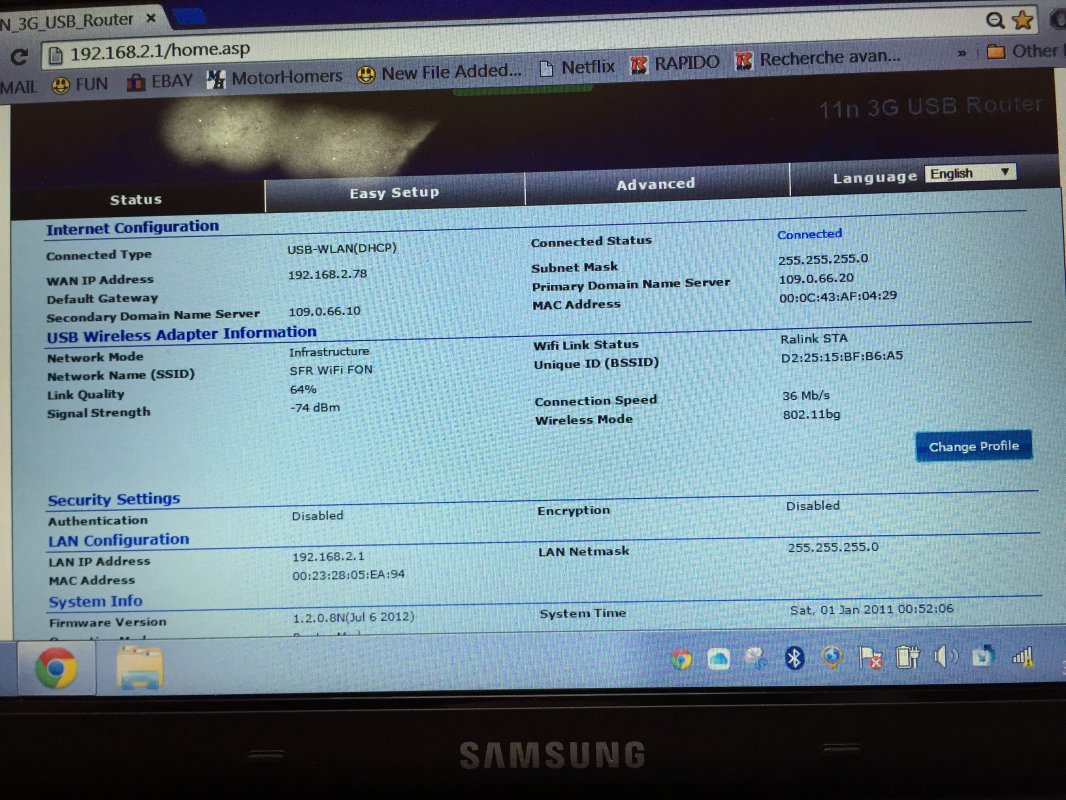

Hi,
I have been using the Solwise 11n3G-USB_Router with the Rocket Ariel very successfully to connect to McD's etc. for some time and am very happy with it, but recently I have been using the SFR-FON network in France.Although I can get a good signal and connect with the router I can not get SFR to push the sign-in page to be able to use the router wifi within the Motorhome. But can connect directly and easily with the iPad phone or laptop if I can get close enough for a good signal.
Somebody on one of the forums of which I am not a member so cannot post has suggested some of the router settings need changing. Steve Mace at Solwise thinks SFR detect that a router is trying to connect so will not push the sign-in page.

OK, I have an alfa r36 which I think is the same as your Solwise. I had problem that router said connected but I never saw the SFR site. The R36 is sent out with 192.168.2.1 as the address at which you log on with your tablet/pc. This clashes with the SFR address sent by the SFR site, which you cannot alter. I have changed my r36 router log on to 192.168.168.1 As soon as you do this you need to log on to router again using new address of 192.168.168.1. This no longer clashes with SFR address and R36 shows connected ( as before) but actually allows me to connect to SFR. It worked for me, good luck.
Sandral, thank you, instant success. If we ever meet I owe you a very large beer or three. I am now connected with the router, SWMBO is happily working on her IPad I am working on mine and BBC Radio is playing in the background from my phone, all connected to the wifi router which is in turn connected to SFR-FON. Sitting in the van on the outskirts of a village with three SFR-FON hotspots over 300 mtr away. BRILLIANT. Is there a bouquet of roses feature on FUN?
That sums it up I had the same problem last year in France.
French Fon routers push out an IP of 192.168.2.80 with a gateway of 192.168.2.81 so the WAN is in the same range as the LAN.
I would recommend you change the LAN address to something in the 10.0.0.0 range such as 10.0.0.254, reason I suggest this is so you don't do what I did, that is change it to 192.168.1.254 then found I couldn't connect in the UK took me a while to realise same problem reversed UK Fon are in that range.

What do I need to change here to get the SFR log in page to come up ?
Never had an issue here before
Looks like your WAN and LAN address are in the same range 192.168.2
You will need to change your LAN range, but on a train right now, so can't remember off the top of my head how it's done on the Solwise
SORTED!! thanks this worked (y)
Can I ask Sandra, did you have to change the R36 back to 192.168.2.1 when you came back to the UK?
Yes, but you can use another range so it works in both cointries I have mine set to 192.168.10.254
For Germany, Deutsche Telekom WiFi Fon hotspots.
No, I didnt change mine back, its still on 192.168.168.1 and it works in UK and france. Good to have info re germany though, thanks
