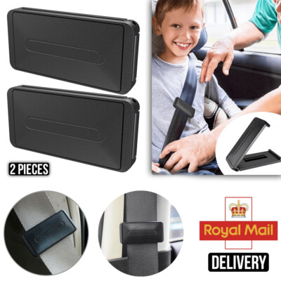

We used something like this in the trucks in work. They were standard in the Mercedes trucks. You could remove some of the tension, but they're not so tight as to stop the seatbelt functioning
Will take a look, thank you

Thanks, ours are fitted to the seat. I'll order the clips and see if they help.
What about one of these, obviously you need to be careful how much adjustment you do so it doesn’t interfere with the safe travel of the belt
Number 1
Number 2
we use the second one on ours, also belt on seat and it cushions it around your neck area
try pulling out the slack with the other hand slowly before you want to move.
me, if they were that sensitive then I'd pull out slack & peg it at the top guide for ease of use.

The seat belt inertia is set by the factory , and that's your lot . What your describing could indicate the inertia system maybe shot , but as it's both i would suggest it is quite normal (i have driven heavies with the same problem) . Personally i would just get used to them , or invest in a pair of those clips , They do work .

I fitted a device that held the belt slightly slack as per the EBay device. My mates solution was to fit a Bulldog clip to the seat belt. Not exactly MOT approved.
