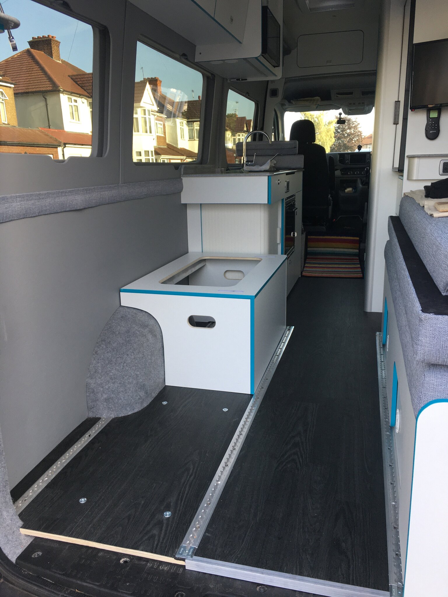

Google Unwin rails.
Link
They are pretty much universally fitted and you can buy a plethora of fixing options. So versatile too.
I’ve got them all over the rear of my van and they allow me to carry all sorts of stuff, incl motorbikes.
The ones on the sides discreetly have a fabric covering.
