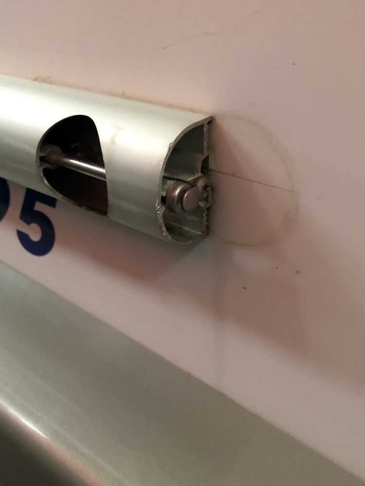

If it’s a fiamma, take bottom plastic covers out and undo little screw that holds pin in place.
Pull pins out and lift rack out away from vehicle and up to unclip.
Easier than unbolting the whole thing like I did o_O
