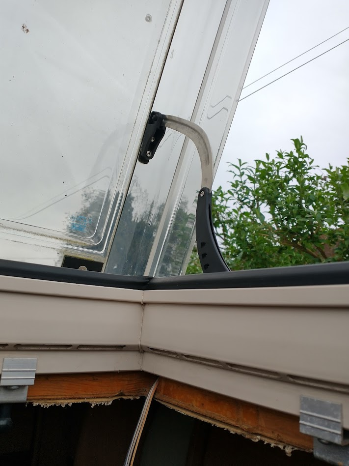

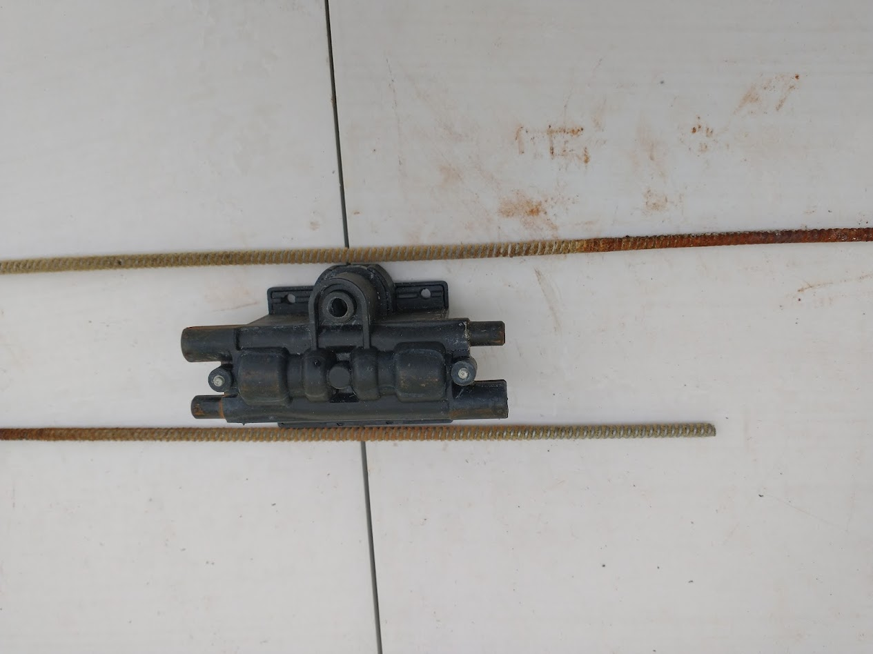

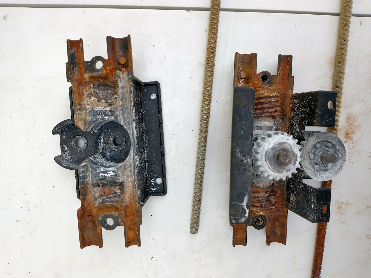

Hi Rev
I have just removed all the winding mechanism inc' the cable screws and sprung stays. The gearbox and cables are badly corroded and beyond repair. The sprung stays are in good condition and working, the only problem with the stays is that the fixing screws won't nip up so I will have to see if there is something like loctight for plastic. With all the gear out the way the roof works well, just release the catches open it fully and the stays go over centre and hold the lid open, just flick the stays back and drop the lid back down.
As for locking I'm happy with the two catches fitted the Same as the window ones.

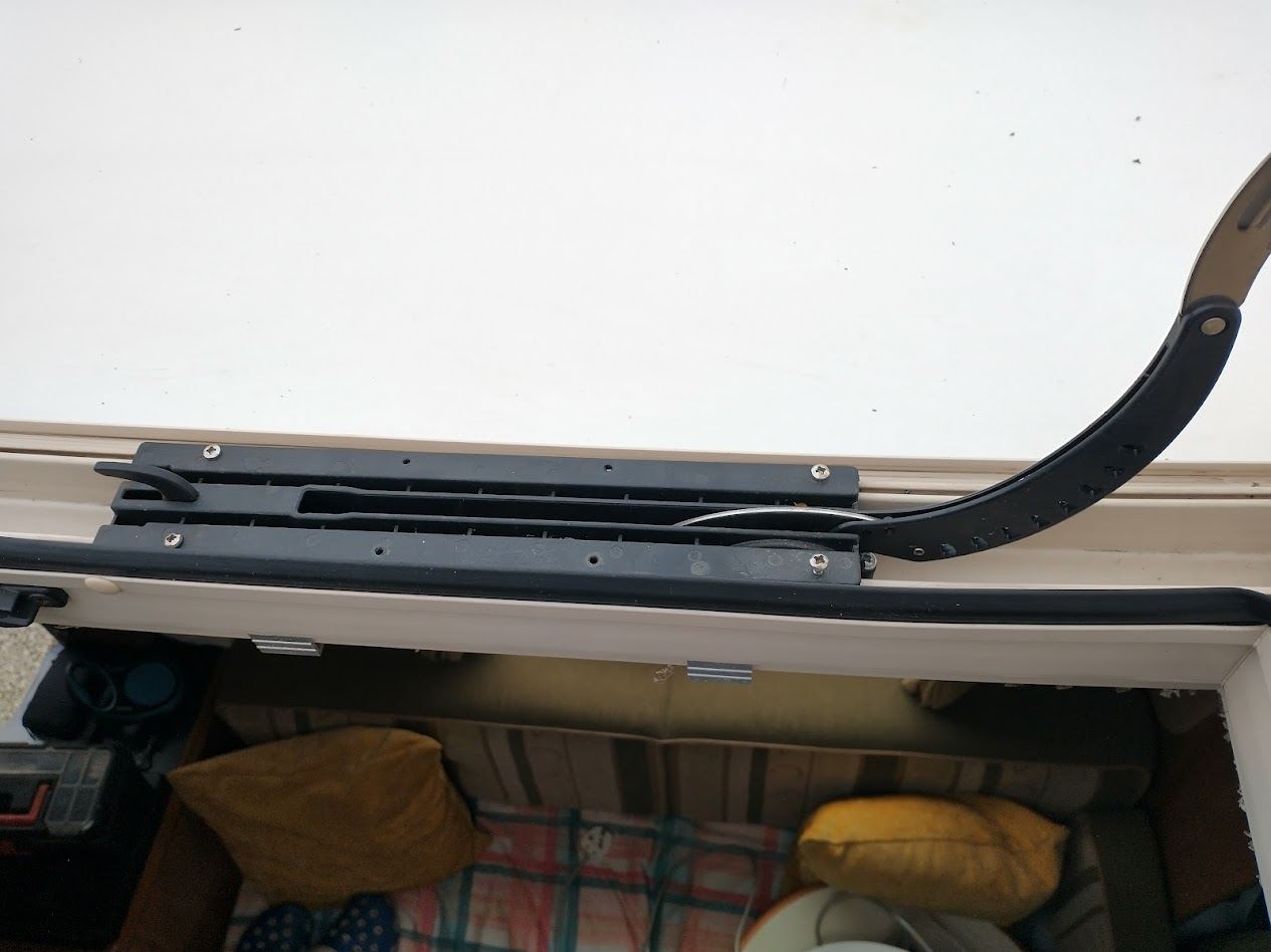

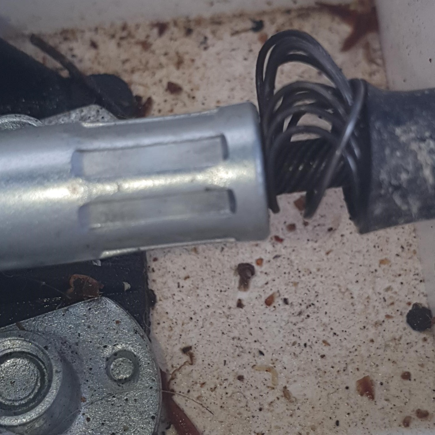

I have an issue with my rear rooflight - I cannot see a makers name on it to be certain, but research leads me to believe it may be a Remis. I am wondering if it is possible to attach struts to mine as the cable has frayed / twisted from one side. I have attached photos of the rooflight, the twisted cable and the unbroken cable.
Is it possible for you to share any photos you may have taken of yours?
Regards, Dave
