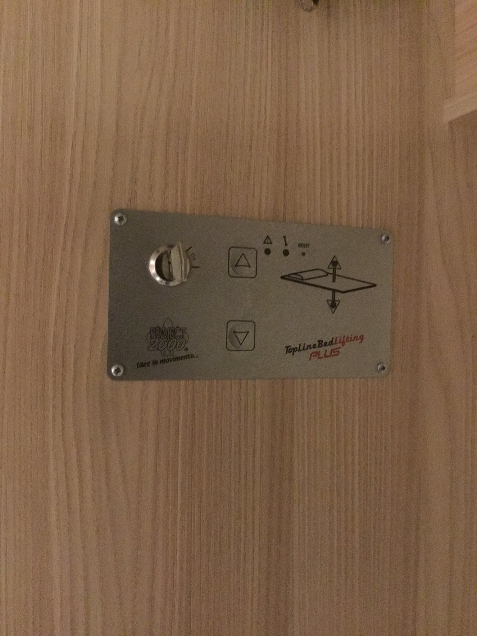

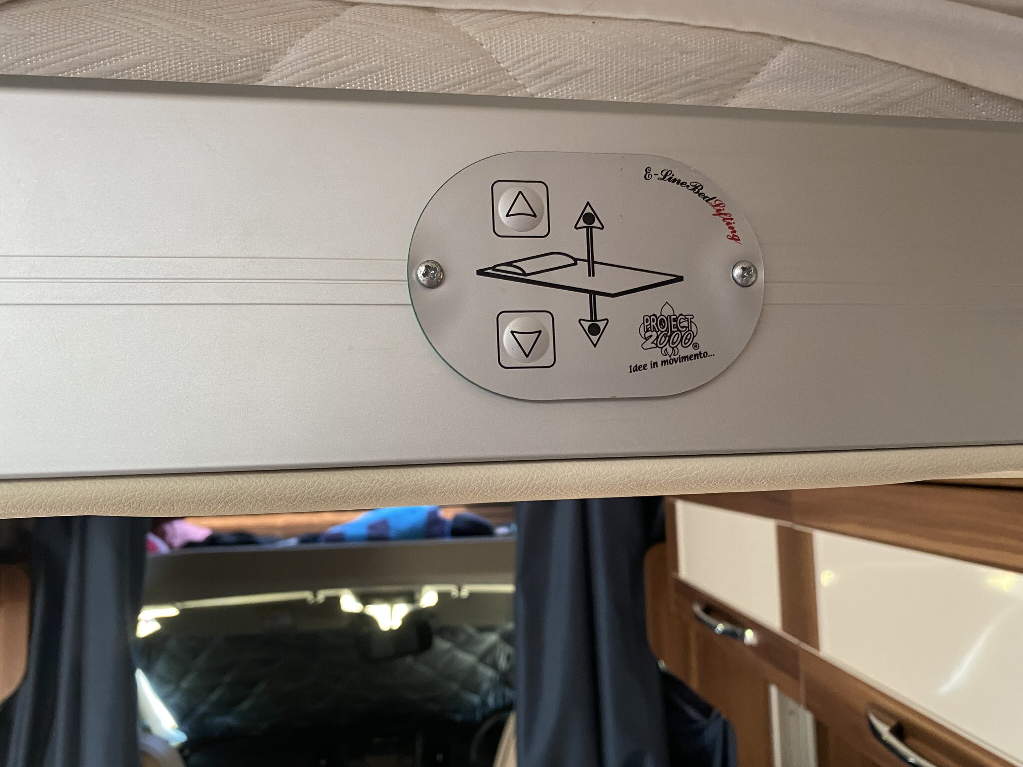

Ours is the version with no key on the 2 button control panel (see pic). It doesn’t appear to have a reset button and at the moment I can’t locate a manual operation point. The operating book that comes with it is mostly useless as it is for the key controlled version.

If you have a hidden button like on the mk 1 you hold your finger on it and press up, up, down,down,then up slowly to reset it. Then you can reset it to your desired heights.

No remote or key. Just a rocker switch which I believe they moved to after issues with the old system.
Green lights did and do come on. Have tested the control switch and appears to be no problem.

Having checked the manual, this also does not quite fit our bed. Ours doesn’t have the Wrench or warning lights and doesn’t appear to have the bill button either.
Phil
Doesn’t appear to have the hidden button, but maybe it is that well hidden I can’t feel it either.😉
On ours which is the older model the reset switch is in-between the up and down and you can just feel it as a dimple between them under the plastic. Hope you get it sorted
Thanks. Will check it more carefully and see if there is something I missed.

I am sure there is, we have the different panel with a hidden button between the up and down switch and with a bit of jiggery pokery can reset the stop limits. These are the reset instructions we use.
Thank you for this. Could well be useful, if I can get any further with finding out how to access the programming aspect for this panel.
