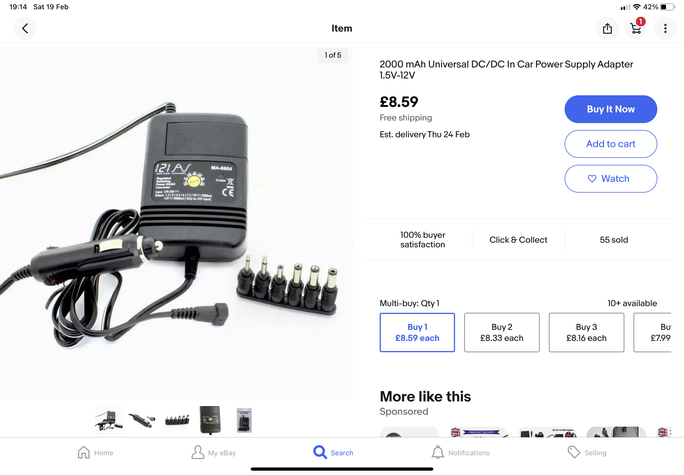

This would work.
Yes. I was hoping there would be a simple fix using a cable which plugged into router one end and cigarette lighter socket the other like the alternative cables for the TV.
Check the Chinese shops for something like above .
Plugs into the 12v DC cigarette socket and can be adjusted for various voltage outputs.
Beaten by almichie (y):LOL:
Posts crossed. Yes something like that is what I was thinking. I have a number of things that do plug into the 12v sockets such as TV, sound bar, couple of rechargeable LED lights and even a hoover. I will have a look at what size plug tings they have and what volts/amps they are for. Surely if similar I could use one of them.
Didn’t realise you could get variable outputs. Thanks to both of you I will have a look.
Thanks. Hadn’t looked closely enough as using phone not iPad at minute.

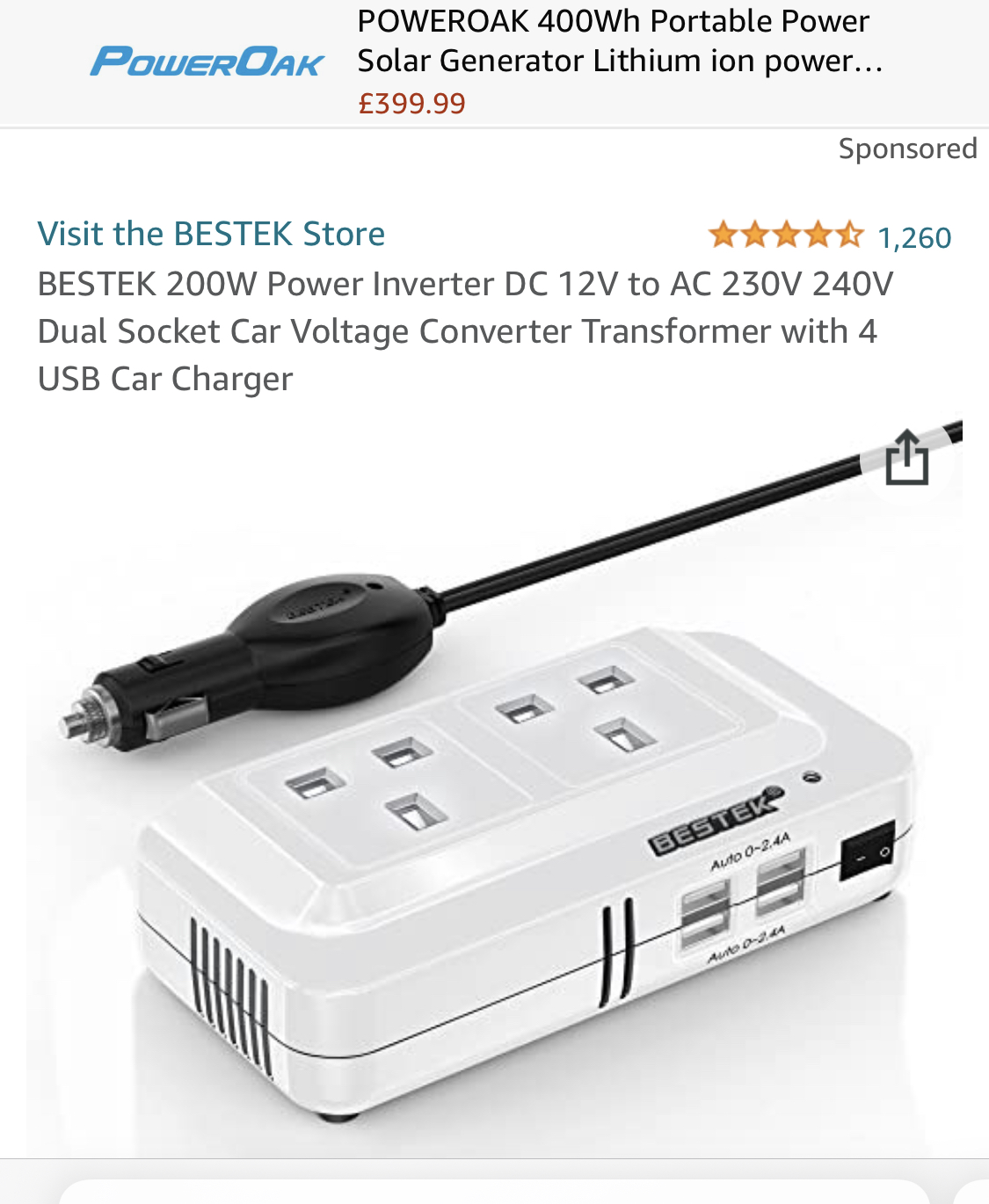

almichie tonka Been having a good look at what is available and what I can buy here. Would something like this work. My router has a Spanish plug and this is available on Amazon Es with sockets to take one of them. Can I assume that if I plug this into the 12 volt supply Incan then just plug the router into it.
Thanks really appreciate all your help.
Oops. Forgot the link

Yes you can, but it will take more from the battery that using a voltage converter
That's an inverter, so your will go 12vdc up to 240v mains and then your router adaptor will be converting it back down to 9vdc...
It will work, waste some power in the conversion but it would be very minimal.
If it was me I would prefer to just go with the 12v adjustable adapter.
Thanks for the explanation. The problem is I can get things from Amazon ES via a friend here but to have something sent from UK is a nightmare. Have been looking in Chinese shops today bu not found anything yet. Will persist in my hunt if places here and preset above as last resort. Once again. Thanks
