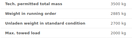

The only manufacturer I know that quotes unladen weight is Carthago they quote both unladen and MIRO they started doing it 2 or 3 three years ago. Probably to give the impression of more payload.
This is from one of their small CompacLine vans.
