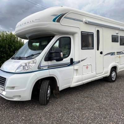

We have been to view this Motorhome, they layout it pretty much spot in for us and it felt like a nice place to be, lots of plus things about it that we like, however they didn’t have a weight of the van as it stands and after a bit of research the payload ( maunufactures figure) is at 390kg, but then of course that’s not including extras like the awning etc.
clearly this isn’t really enough even just for the two of us, so how do I find out how much I can up plate the van ( c1 licences here so no issue there) as we’ve not found another van that has this layout that is in our £30k price range.

If its on 215/70/r15 tyres and rated at 3500 kegs, you could fit semi air assist I fitted mine in around three hours. To get 2240 kg on the rear axle you will need 225/70/r15 tyres this will give you3850 kegs, i bought my gear from SV TEC and got them to do the plate and paperwork.
You should be able to uprate to 3850kg, the awning won't affect payload as it looks like a standard fit on that van.
You need to get it weighed and check the axle weights. If you want to uprate the rear axle to 2240 you may need semi-air, on a Fiat chassis around £500, if an Al-ko chassis £2000. 16" wheels will be OK if 15" wheels tyres would need uprating.

With 15" wheels you just need to fit tyres with a higher load rating which means going from 215 to 225 width.
Just looking at it it is only 6.7m and has a very short overhang so I reckon you will not have any problems with the axle at the standard 2000kg.

Yes but then your spare wouldn't match.
As I said I don't think the standard rear axle will be a problem, it's got such a small overhang compared with the norm of 2 to 2.4m.
Ours was a 7.5 coach built, on a panel van the loading will be different, SV tec will put you right. I changed all the tyres, you could if required just change the rears and spare, then do the fronts when they wear out to keep all the same.
