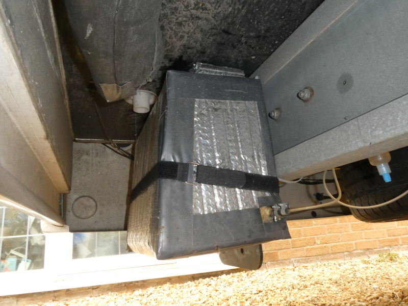

My diesel heater fuel tank is mounted externally under the back of our van.
I had a mate weld up an aluminum tank for me which holds just under 15 litres.
I made an aluminum "L" bracket to hold the tank and this is bolted to the rear chassis extension under the van on the driver's side, and it's filled via a filler point in the van's back panel that I bought from a boat chandlers.
You could probably do something along the same lines with either a metal jerry can or outboard motor fuel tank.
You should have said when we were parked across from you at Newark as you could have had a good look at the install when we were there.

Thanks for that,someone had a deisel heater that contained the fuel tank,5 litres, sort of portable,that he kept in his garage until it was used and then placed it under his van and just plugged in the 12v and the blown air duct.
I had thought of a deisel heater prior but all the storage space in the 175 is internal and I didnt fancy the idea of having deisel inside the van.
I did see a good YouTube vid where the fuel takeoff had been done through the main deisel tank vent outlet utilising a narrower bore take off tube.
So lots of different ideas to consider.

Plumbing into your van fuel tank would probably be your best option.
I went the external tank route as I run our diesel heater on home heating oil as we are on heating oil at home which is considerably cheaper than road diesel.
Yes the other options are red deisel and kerosene, which was being used by the portable heater I saw.. (y)
