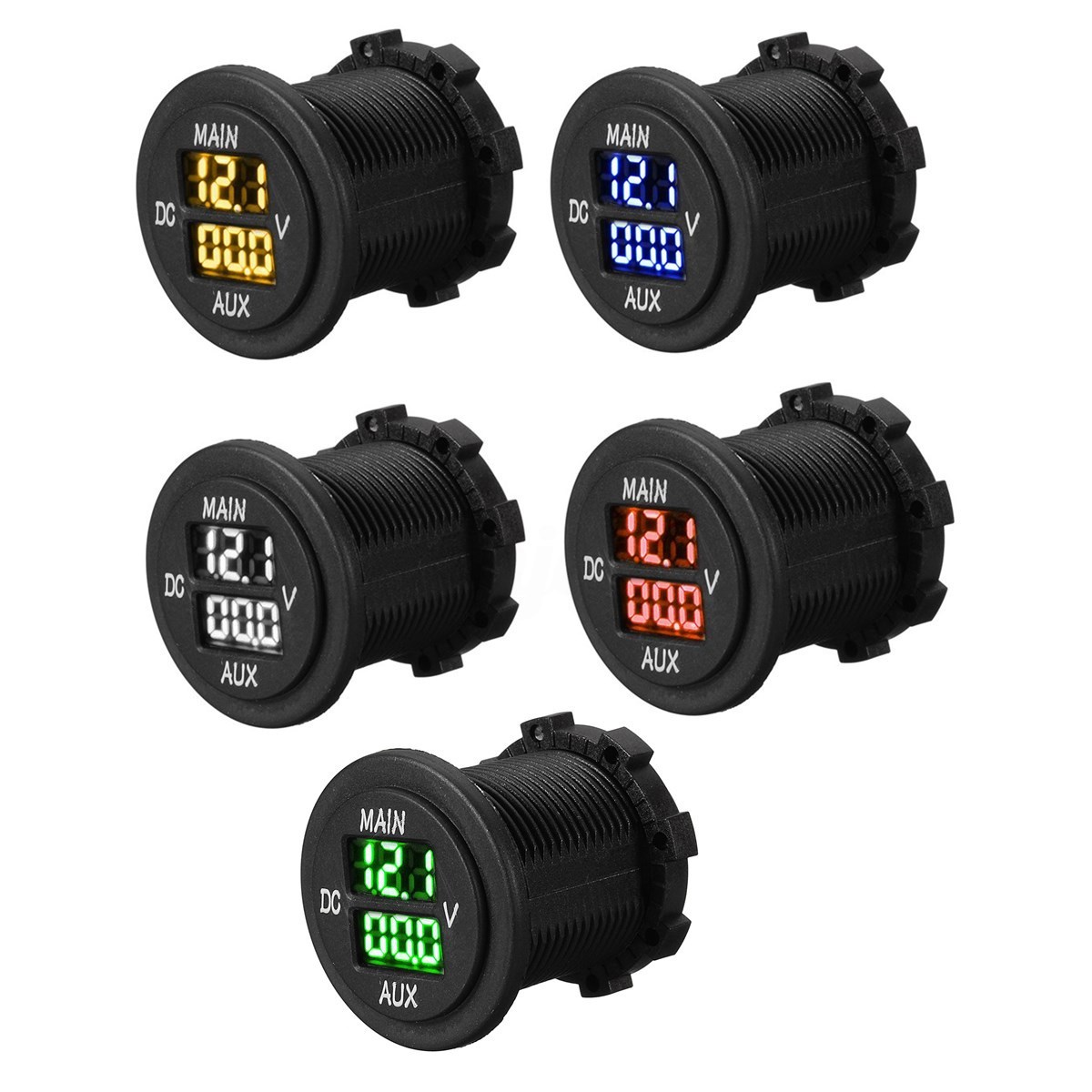

You don't have to spend a lot on a battery monitor if all you want to do is see what's in your batteries ... you can get all sorts of cheap ones, I've just wired in one of these to our cab battery as I already had it:
For our hab battery I just stick one of these in a socket:
You can also get one that shows both cab and hab batteries levels:
There are loads and loads of monitors on Ebay so have a shuftie and see which meets your needs.
