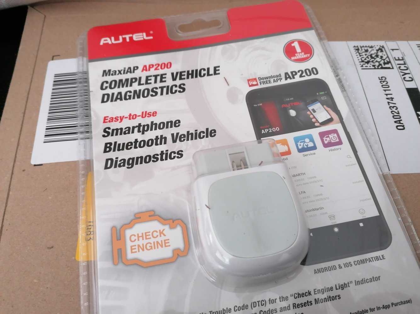

Just to update this thread, I did order the Autel AP200 in the end:
I collect my van from the engine builders in a few days, then fit the passenger seat back in and pop it across the road for an MOT re-test. It failed on the airbag light being on (because the seat was out) and I wasn't 100% sure just fitting the seat would switch the light off.
With this I should be able to reset the light.
Can't test this yet as no van, but once I have I'll update this thread on what it can do with a Peugeot or Citroen.
