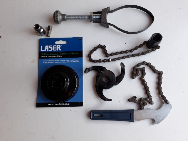

You need oil filter, oil and a means of removing filter and refilling with oil
There are videos and instructions online this is my view on my 2017 euro6 ducato.
It should be easy. I changed oil and filters for over 40 years. I even made them summer 74 coopers filters llanfoist ( near Abergavenny) typicaly they are replacement cartridges as in A4 a d my fabia, the up and ducato have replacement spin on cans.
The most difficult was the up straight from the factory, broke 3 tools and had to resort to big screwdriver trough body and 2 people, 1 pulling one pushing a right pain. The easiest, today with the ducato.
Note bought removal tool15 flats for mahle filter supplied as oem but took off a mopar filter.
Used tool top of picky
12mm hex socket for oil plug

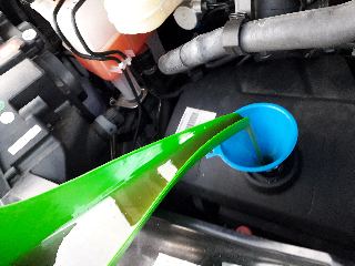

Watering can to refill with oil
