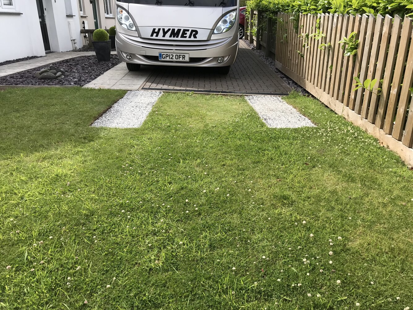

This is what I did...
Two trenches, compact rubble, Plastic grids, membrane, sand and artificial grass so when away for weeks on end...😃
Thanks to the side fence I put a marker there to know the end of the runs... the grass really does bounce back ok so no tyre marks..
