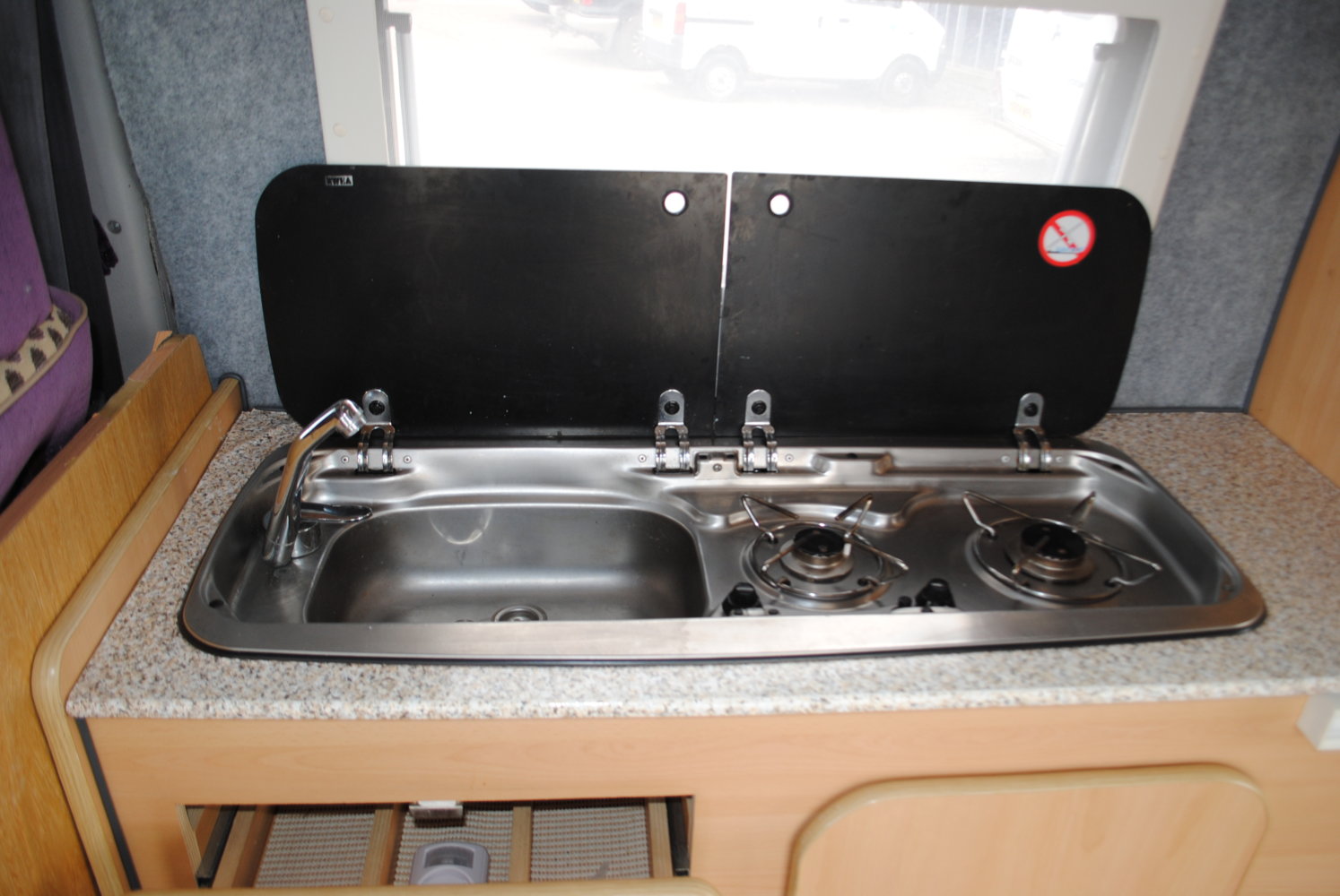

Hi all,
Some advice please... Our camper van failed the MOT for extensive corrosion to the underside, (All wheel arches, LH sill and the rear end) (And Discs and pads). The corrosion is quite enough for the van to be scrapped as it could cost as much as the van is worth to repair (You just done know how much repair is required). We have decided 'get rid' of the van as it is, but I don't know if its worth selling as it is, or breaking for parts and then disposal. The interior is in good shape and was new from 2012 with a professional conversion, includes rock-and-roller bed, pilots seats, gas heating and stove, elec inverter, fridge, microwave, sink with elec pump. 1.9TD engine (Classic XUD9 TE).
Photos should be attached to this post. I have additional photos if anyone is interested.
Located in Nottingham
Any suggestions / offers welcome.
Mark.
