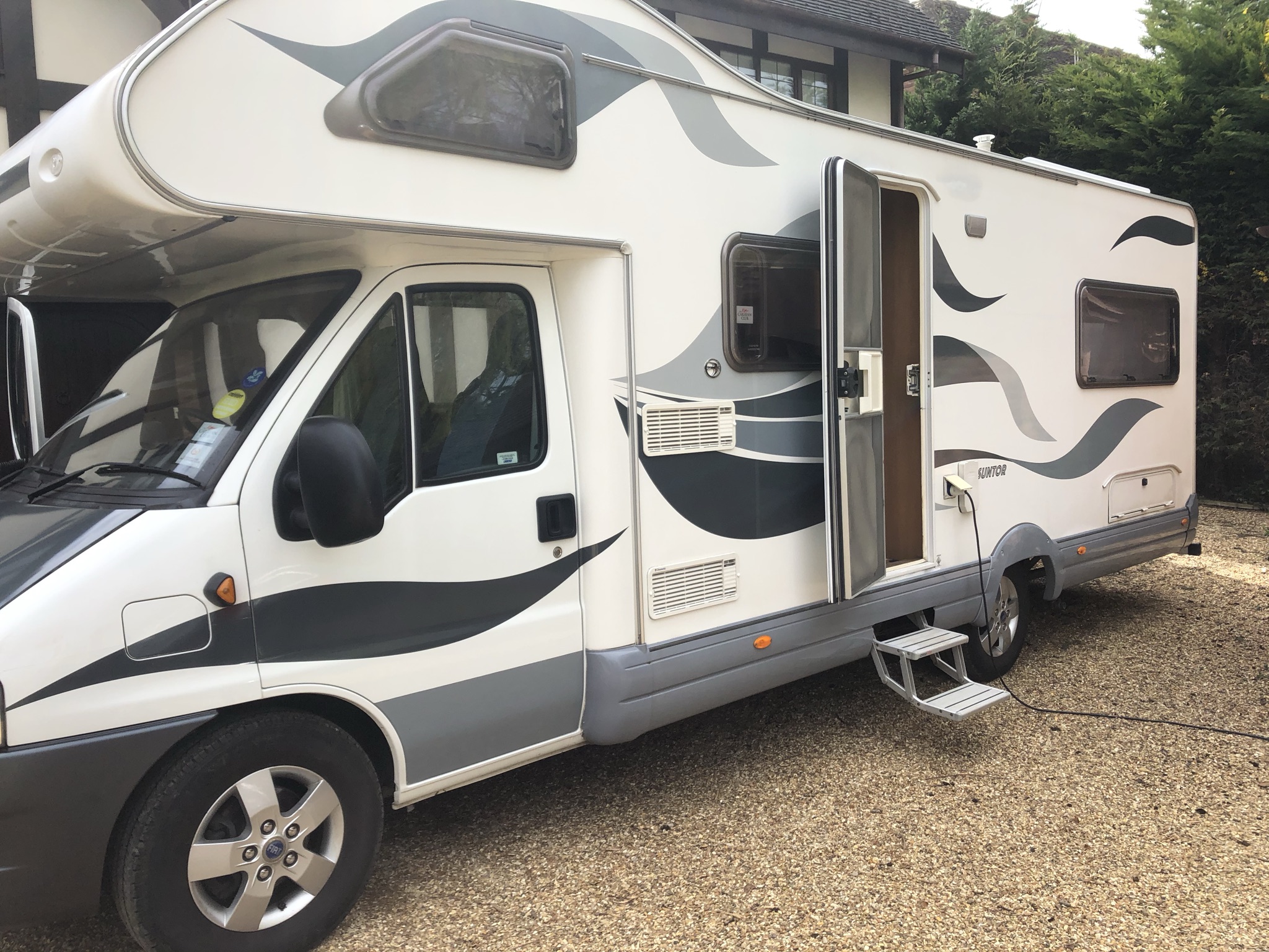

This is the motorhome

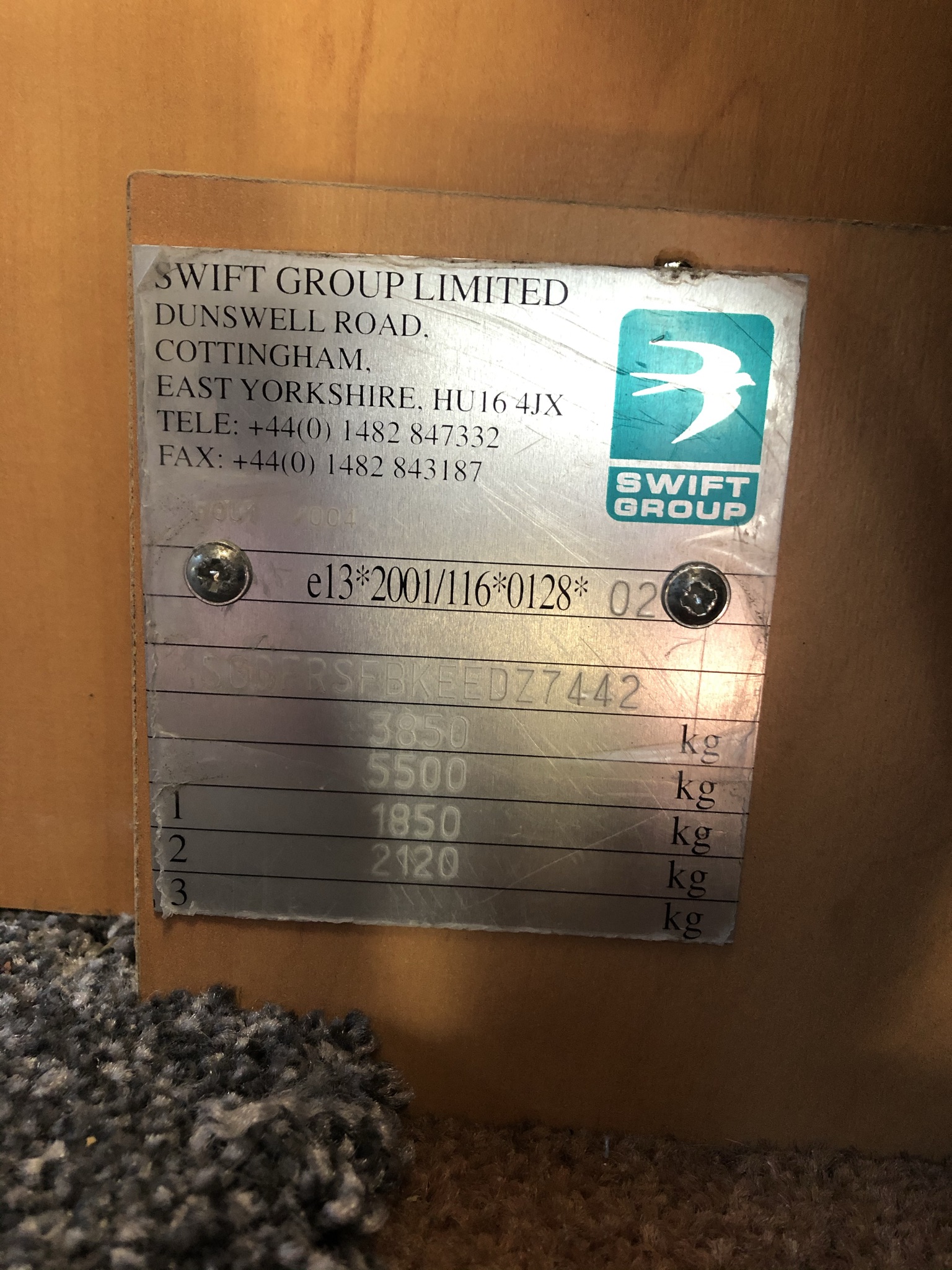

Hi I found this down the side of the passenger seat

Good that’s your convertors plate Max GVW 3850 so you’ve got a bit more to play with but your. Axle weights are the important bit 1850 front & 2120 rear can’t be over weight on either so load up ready for a trip and get to a weighbridge. I usually weigh whole van and then just rear axle and deduct from whole to give front axle.😊 good luck
Maximum weight allowed is 3850
Max weight with towing 5500
Max front axle 1850
Max rear axle 2120
The only way of knowing if you are within limits is to go to a weighbridge.

As per the book in your previous photo then.
Max weight is 3800kg
Max train weight (with trailer or towed vehicle) 5500kg
The important part is also the axle weights, you mustn’t go over them even though you might be below the total weights.
Front 1850kg
Rear 2100kg.

Looks to be the same as my swift sundance 630L .There is a claimed payload of about 550kgs but as mentioned the only way of knowing what payload you have available is to visit a weighbridge . You don’t appear or have an external wind out awning fitted which will help as they are quite heavy .
