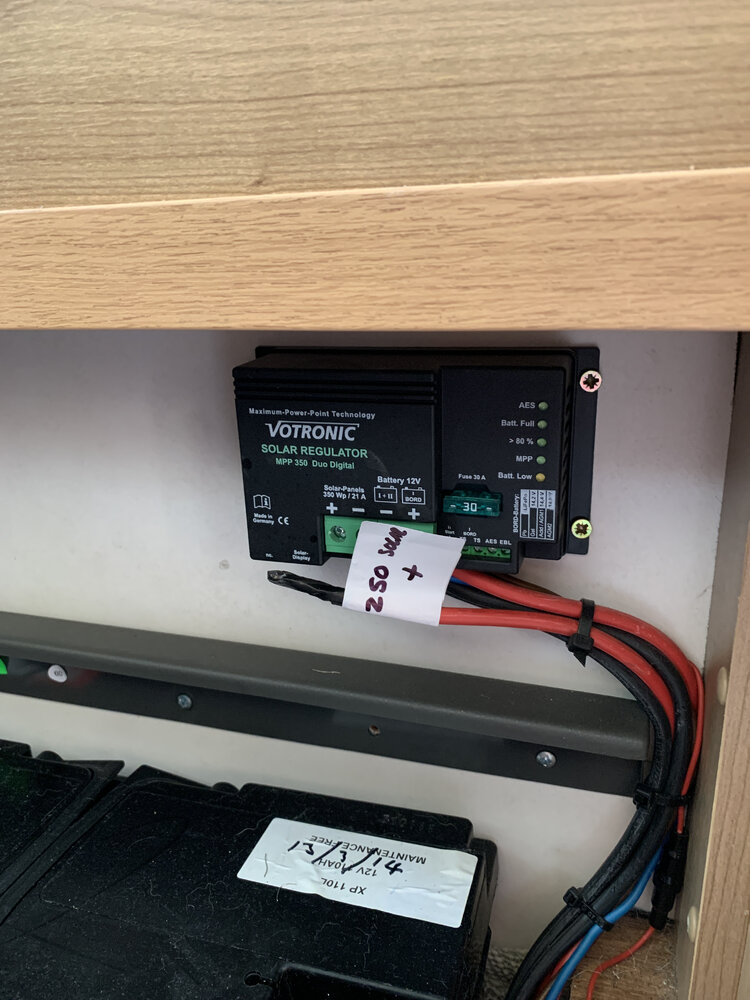

This is my current setup, space is tight and to be frank, it’s a mess!
Not far for the invertor, 1200w PSW. The cables where it connects though seem to get hot at full whack so will be re doing those connections too.
You can also see the Votronic MPPT which I will be moving to inside the battery compartment where there will now be room after ditching the second battery.

Just realised that the old solar controller I have won’t be compatible with lithium.
I have two, one for a 250 watt panel which I installed which is the Votronic and the older one which doesn’t have a lithium setting and is connected to a 90 watt panel from when I got the motorhome.
That’s annoying as I will also need a temperature probe for a new Votronic controller as well as one for the controller I already have.
As reluctant as I am to spend another £100, a 90 watt panel will help top up the lithium in the darker months and as all the cable panel are there, I may as well do it properly.
