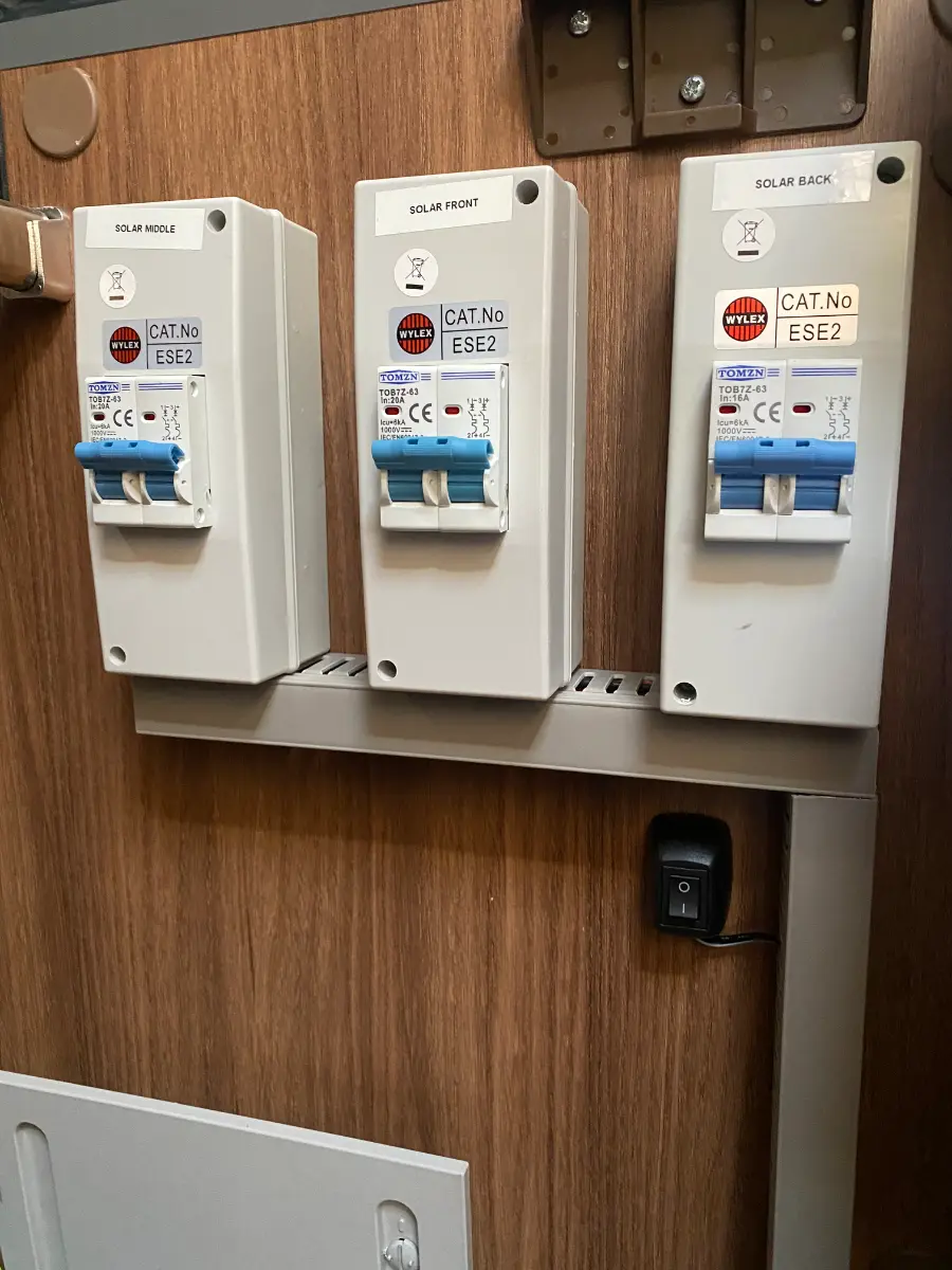

In line switch fitted, and working!!, thanks to Nigel and Roger at off grid for the advice and the supply of the switch kit.
