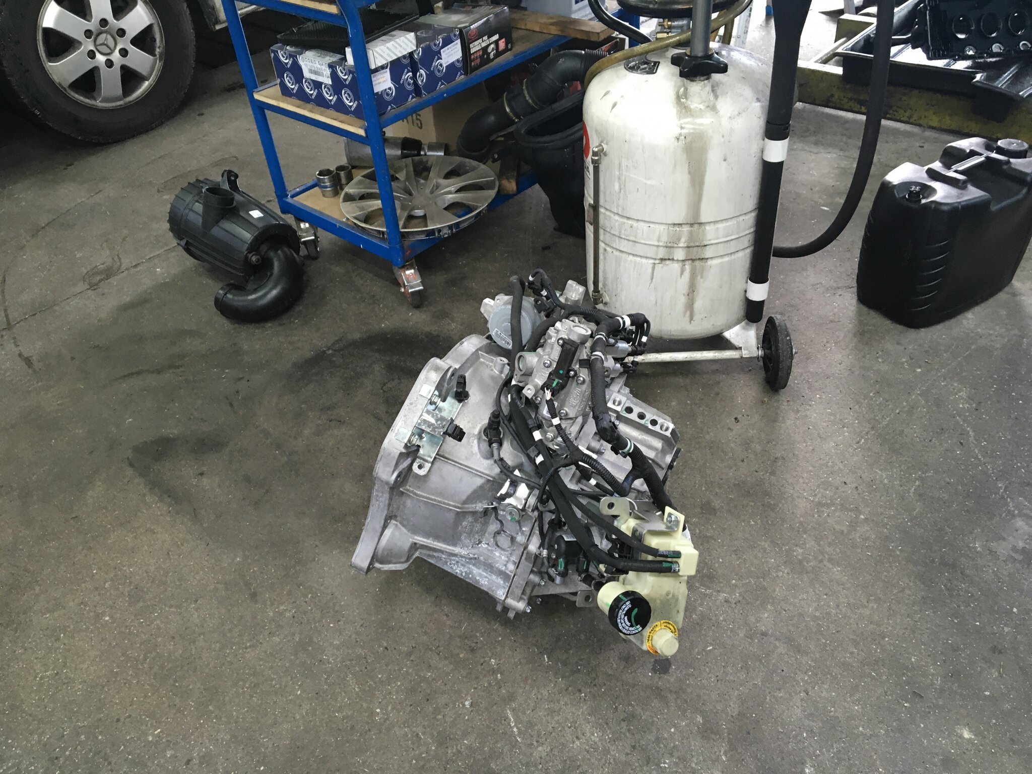

In September, our trip to Ireland was cut short due to the Fiat Comfortmatic gearbox unable to select 6th gear.
The Carlisle NEVAT have so far proved to be not as on the ball as I would have liked. I have spoken with the poor receptionist and she tells me the work is likely to cost in excess of £3500. WTF? The engineer is always out or not available.
So, it is official, the worst auto box of all time is the Fiat Comfortmatic.
For what it's worth DTC Codes are P2915-72 and P2919-64.

I've not had much to do with them for repairs, but their Iveco parts are always too expensive. A gear lever assembly from them was nearly £200, I got one from Coastal Motorhomes for £69.
I wish I could recommend you someone else in the area cos £3.5k for a gearbox repair is ludicrous, they're obviously just thinking of replacing the complete box by the sound of it ?

The hydraulic actuator/gear selector pack for the gearbox was quoted to a friend at £2,500 4 years ago. That's not including fitting.

It's not the gearbox that's usually the problem, it's the garage's lack of knowledge. Get them to enable clutch auto adjust and off ya go. If they say ? then point proven, if they say already done or couldn't find a straight stretch of road then fair doos there may be something mechanically wrong.

We've just had our Comfortmatic gearbox repaired under warranty by NET&V (York). They have service and repair contracts with public authority vehicles and handle lots of Ducato ambulances etc. They are FIAT Professional workshops and I believe they are best placed to sort your problem but I understand they are very expensive going by their quote of £324 incl VAT for an oil and filter change.
Ours apparently needed a new flywheel and clutch which is about 2 days work. However, because they prioritise non-warranty work, (FIAT pays them less?) it took them 10 weeks to get around to the repair.
