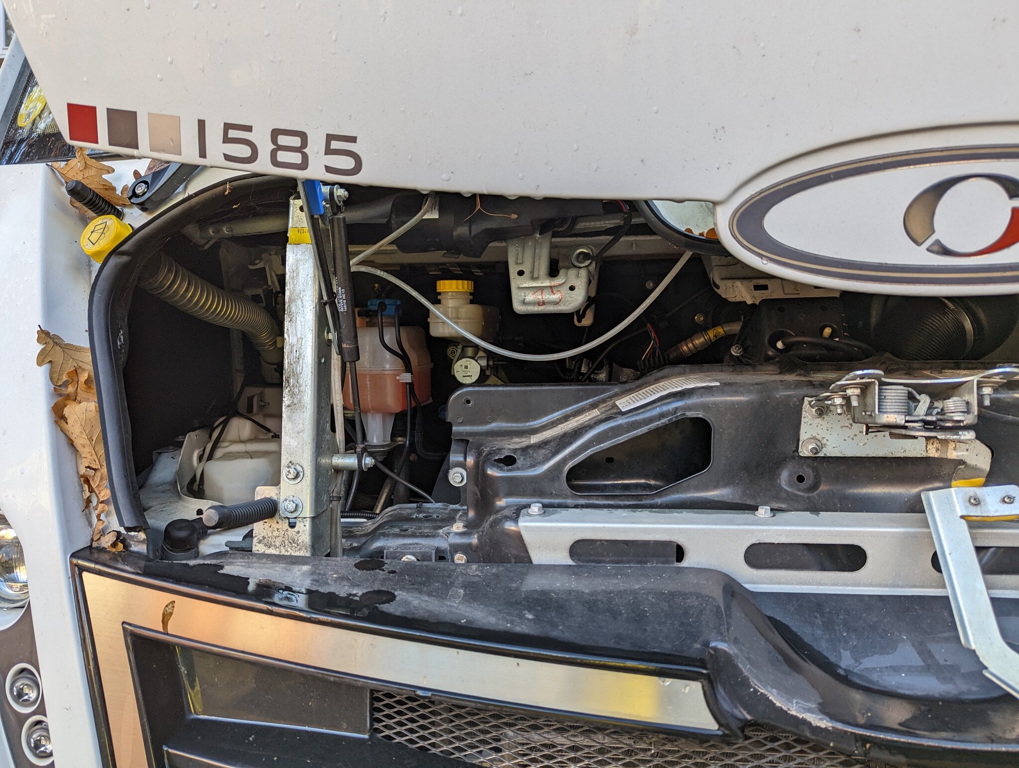

Can't see anything on top of the engine. Two pix attached. It's not one of the reservoirs you can see is it?

I'd be tempted to take the lid off the yellow one and see whether it has an oil can symbol on it. Modern engines tend to be colour coded for the various fluids you can put into them, and yellow is usually oil.
That is the brake master cylinder.

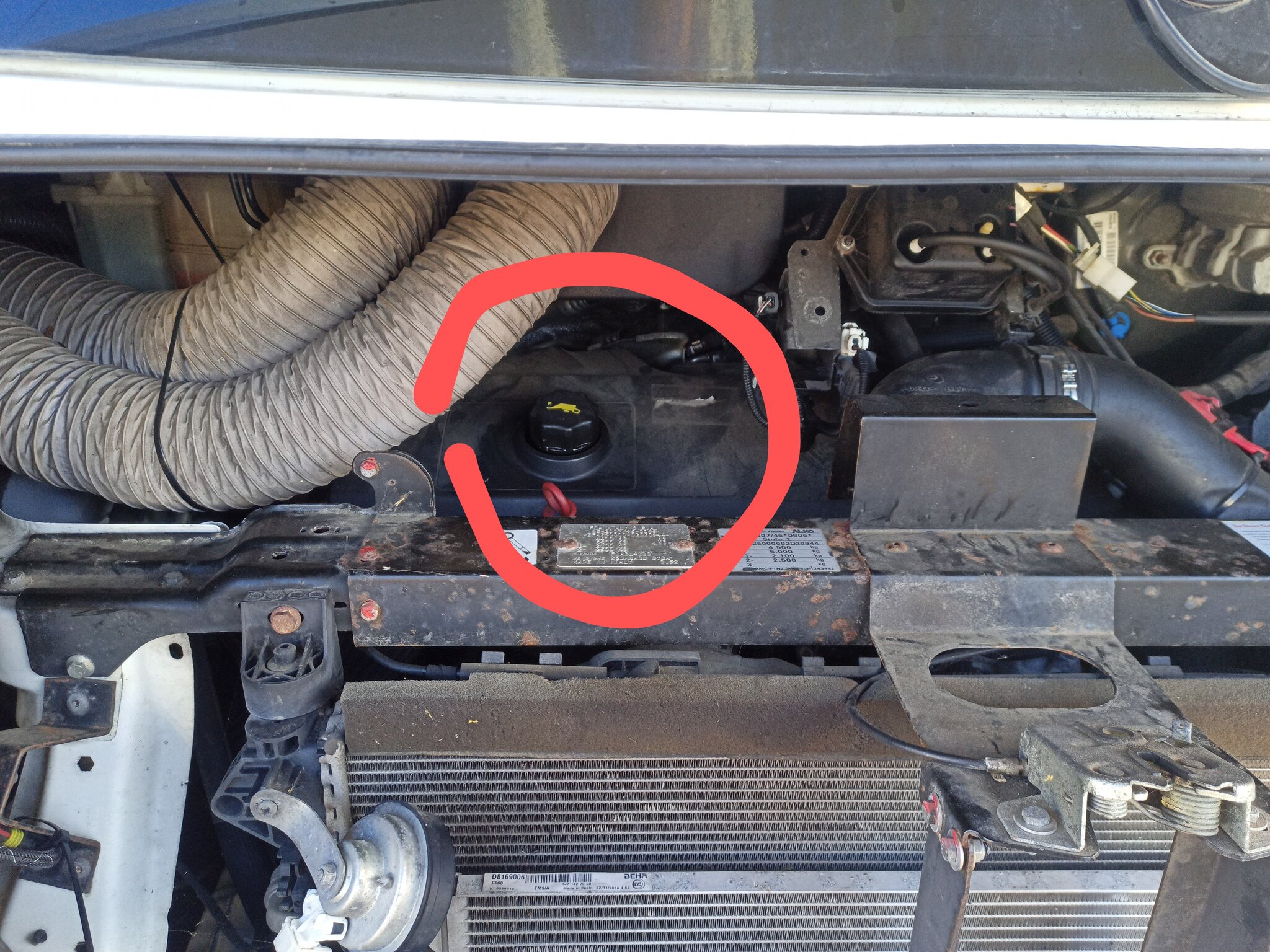

Here you are mine is an A Class 2017 Fiat.
Thanks. As you can see, ours looks nothing like that. Also 2017 Fiat. I'm thinking that big black cowling needs to come off on mine. Of course it's wet and miserable and I've got a cold...... Par for the course.

Stand facing the engine on the left hand side to the right of the brake cap (yellow) there should be an engine cover, feel along that towards the front and there is the oil filler cap you don't need to take off the black cowling but it is a pig to top up Oh and hard to spot as its black and well hidden

You need to stick your head into the engine bay and look behind the metal framework diagonally right (south east) of the yellow capped filler bottle. It's a pig to top up - hubby uses a small Lucazade bottle and puts some oil in that then is able to pour it into the filler with that, its a prat but doable.

You can’t get clearer than that oil filler cap in the bottom right of the lower picture!
On yours, agreed. On mine, it's invisible. Hidden behind trunking. Obviously, easy when you know where to look.
