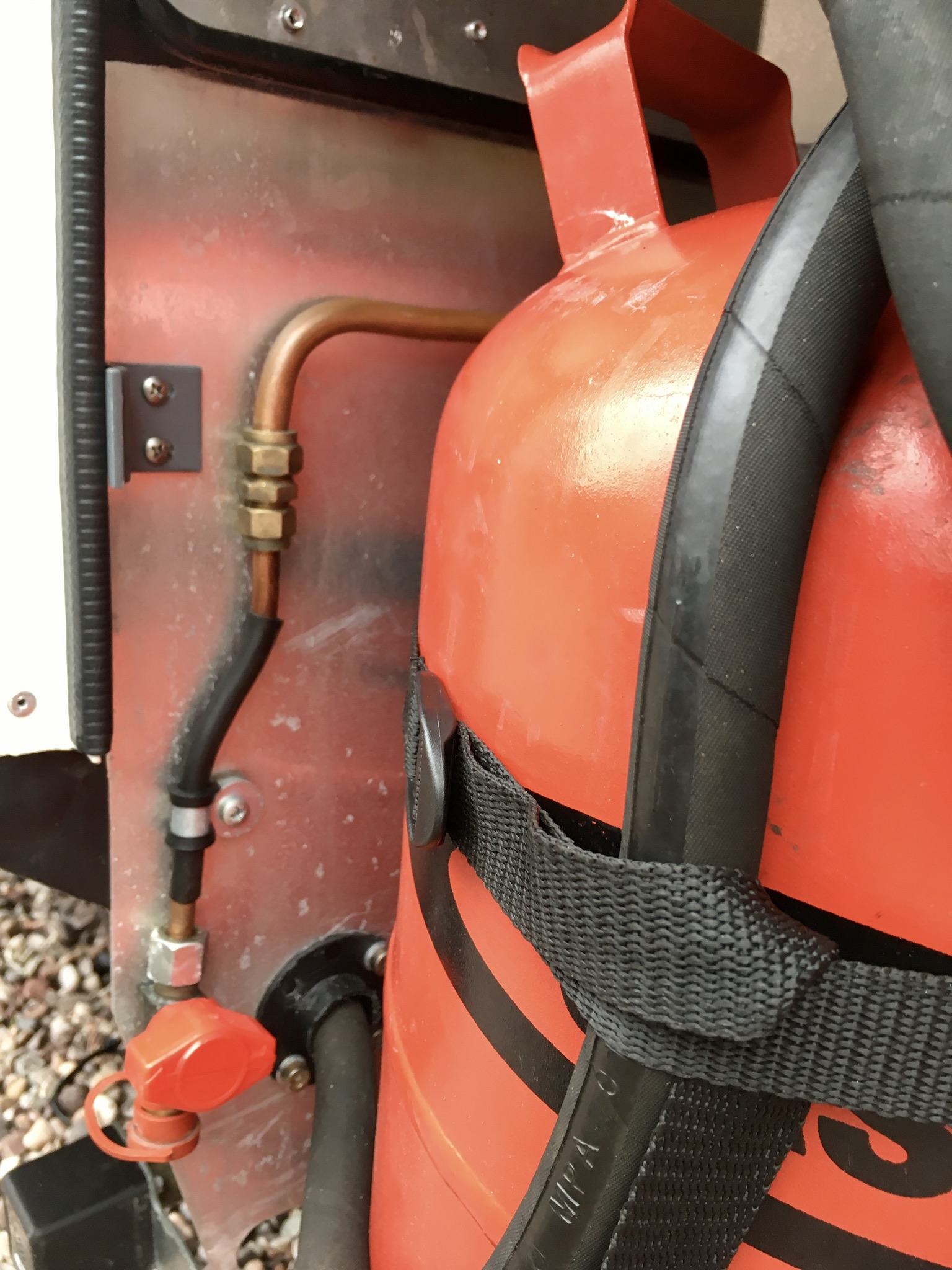

I fitted mine in the gas locker and just throw my pipe under the van. I didn’t want to dig a hole in the side
Plenty of good options, none of them involve fitting an outlet in a door that will move. Install inside the gas locker and leave door open to use. or fit near the fridge and tap into the fridge gas supply. Easy enough to do and if the van is not rented out, legal to do yourself

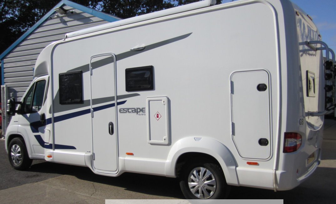

It’s a Swift Escape and the filler is inside the locker.
What model/year? The reason I'm asking is so I can have a shuftie at photos and see what the locker etc situation is and thus make more specific suggestions.
Escape 695. 2017 model.
Thank you
You can get quick release gas fittings and flexable thermoplastic gas pipe. Think the pipe is available from gas it and/or ebay. The pipe is used on vehicle gas conversions so been around for a while and can be used on either high or low pressure side of regulator.
As already suggested a fixed point connection in the locker and longish length of this piping.
I assume it's like the below:
You could put a connector below the skirt next to the side of the step where its likely to be stronger - by dropping the pipe down through the gas locker drop vents (make a hole in the mesh etc), you could also put a fill point there too to save you having to open the locker door when refilling (turn the cylinders off BEFORE you go into the station to fill so they don't know they're cylinders). You can get smaller fillers and could also put a BBQ quick release connector in a small 'box' type cover too to protect it from dirt etc rather than go for the usual BBQ connectors. You'd need to put a manifold/isolation tap in the gas locker itself for the BBQ though so for safely you can turn off the lpg point when its not in use.
