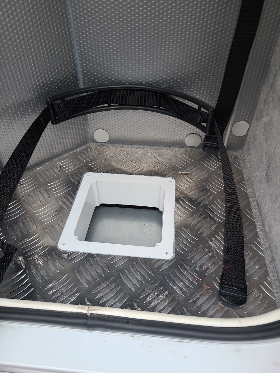

Hi again everyone. Following on from some great responses to another question I have decided to install Gaslow with an external filling point mounted on the skirt.
The main challenge is getting the hose to under the van. I would like to avoid drilling through the floor given how well sealed and thick it appears. It would be preferable to go through the drop vent.
The problem there is that it is directly under where the cylinder stands. After getting to vent there is an easy route to the skirt through the vent and out.
There is plenty of headroom above. So options seem to be
1. Steel hose through one of the gaps at the bottom of the cylinder. This seems like a bad plan because of risk that cylinder moves and disrupts the hose.
2. Build a small wooden platform to effectively raise the floor and to raise the cylinder. This would allow me to cut a hole in that to thread hose through and down into the vent.
3. Drill directly through the floor
I haven't bought a cylinder or kit yet as I peruse the options. I am hoping that a single 1.5m hose would run from cylinder to the fill point but I need to properly measure. I also wonder whether there would be sufficient room to avoid any undue bending of the hose.
Any thoughts based on your knowledge and experience?
Many thanks
Two pieces of 2 x 1 or similar cut to a cross with one mortice and tenon joint at the middle should do it then add rubber door stops at each corner of the cross using long self tappers so that they engage lightly with the floor. Job done and plenty of space for gas escape if something goes wrong.

Brilliant, thank you
Choice 2 build a platform for the bottle to stand on with a gap for the hose.

Doing a bit of homework on this don’t I need a cross lap joint?
