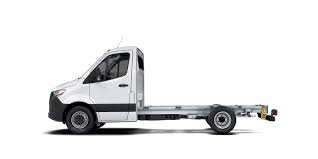

But the Mercedes ambulance is a solid cab - the box on the back can be unbolted leaving a full cab and chassis - no motorhomes are made with this construction.
That does not change how the front of the cabin resists to a shock.
I can only guess that you know little about structural engineering. The full cab is a game changer as to how the front of the cabin performs - think coupe vs convertible.

I'm not sure I understand well what you mean by the full cab (English is not my native language).
If you mean the whole vehicle including the whole body that is added by the conversion, I don't agree.
If you mean that cutting out the roof of the cabin can and will severely impact is structural behaviour, yes of course. But that roof is cut for the ambulance too.
I find the behaviour of the Sprinter in the case of the ambulance is more encouraging.
If you look at the ambulance video again at about 2:24 they do a schematic that shows the ambulance box is just bolted onto the back of a cab and chassis, all coachbuilt motorhomes have that rear part of the cabin removed. That's where the additional strength comes from.
PS don't worry English isn't my native language either - I'm from Middlesbrough!
I checked, you're right. Not sure if that explains why the front wheel of the Ducato ends up under the driver but OK. I still find the video with the Ducato very frightening and this won't help to make me buy a Ducato if I find an alternative otherwise as good on a Sprinter :) You can call me stubborn or misinformed (both likely true).
Still, in the third video it is clear the Sprinter is better than the Transit and they are both panel vans.
