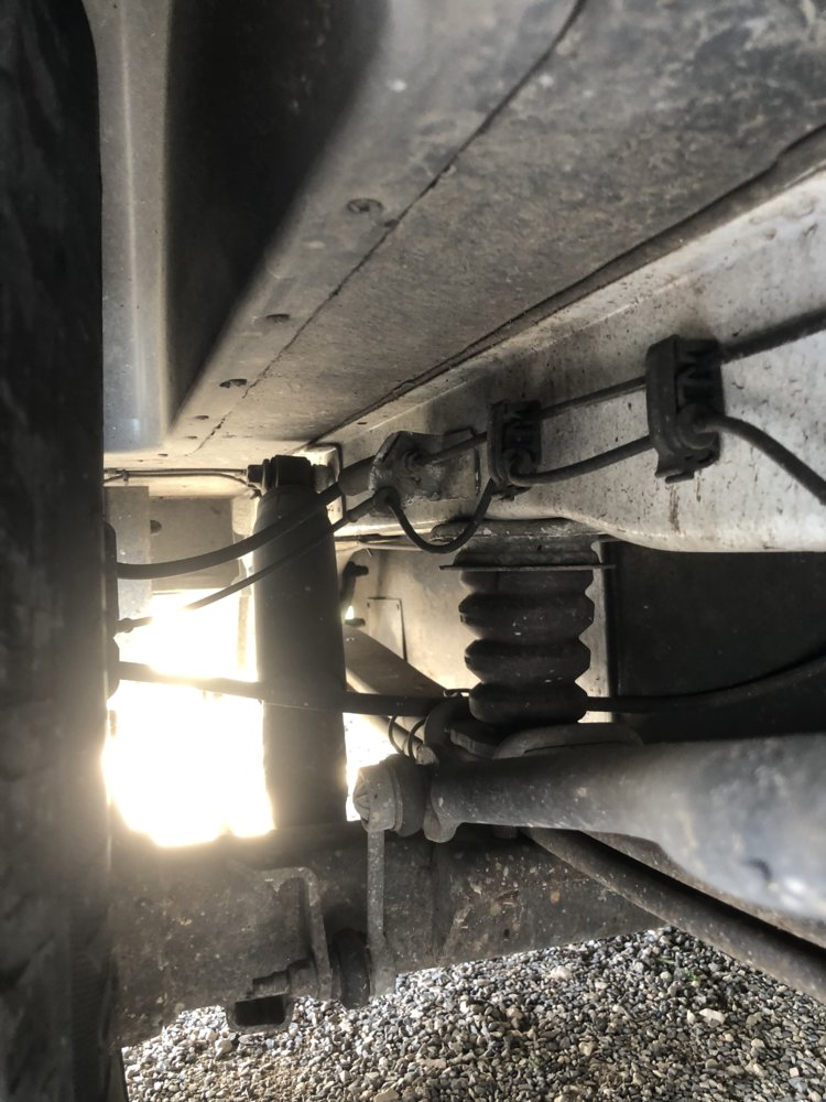

I’m looking at buying this Hymer but I’m concerned about the suspension, any help would be appreciated.
My current van was close to its bump stops on the rear axle so I added Dunlop Air Assistors, very impressed with the improvement in ride quality. This potentially new van (2011 model) has the same standard chassis but is riding on both sides on the bump stops. Worryingly it’s been downplated from 4250kg to 3500kg and is practically empty. Is this normal? Everything is standard and the current owner bought it new and has never replaced or modified anything. These are bump stops, not spring assistors.
I suppose I’m asking, should I be worried about this?

Thanks, these look a bit like my dogs Kong toy, like 3 layers of decreasingly smaller doughnuts. The smallest being closest to the leaf springs.

The pictures below show the articles in question!
Yep, not bump stops but spring assistors, same set up as my 2001 Fiat Hymer was, now fitted ‘easitop air assistors’
I wouldn’t let it stop you buying the van if it’s got everything else you require, but I would budget for £500 to £1000 to air assist fitted to make it a better ride, and also please you MOT man.
They are the standard factory spring assisters. They are designed to be in contact with the spring at even moderate loads. Those in your photo don't even look compressed. There is a Fiat technical document confirming the above. Do a Google search for Matters of Testing and Suspension Assisters/Bump Stops and you will find a DVSA document also confirming the same, and what should be the MOT testers stance. I don't believe even proper bump stops are a reason for failure by themselves in the new MOT test though

I meant that the relevant copy of "Matters of Testing" confirms that the original suspension cones depicted in your photo are suspension assisters rather than bump stops, therefore designed to be in contact with the springs in normal use and not to be considered a defect.
