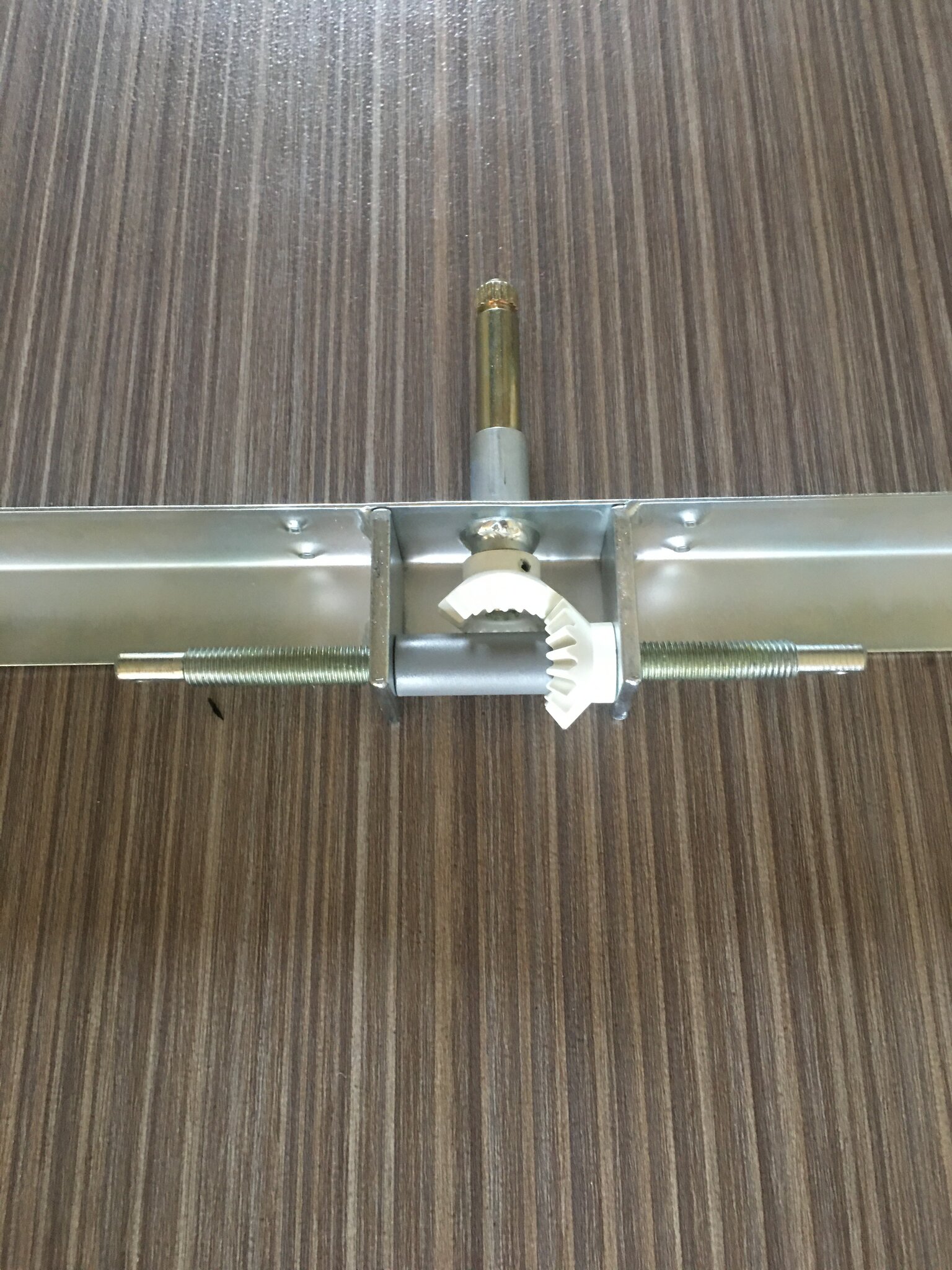

the mechanism is ridiculously complicated, the handle is attached to this (I will explain photo later)
The handle turns the spindle, which then moves 2 cogs to move bars that lift the roof light, bit like mousetrap

found on eBay Brownhills selling just the mechanism in photo above, still not cheap, but in stock so ordered, delivered for total £98
