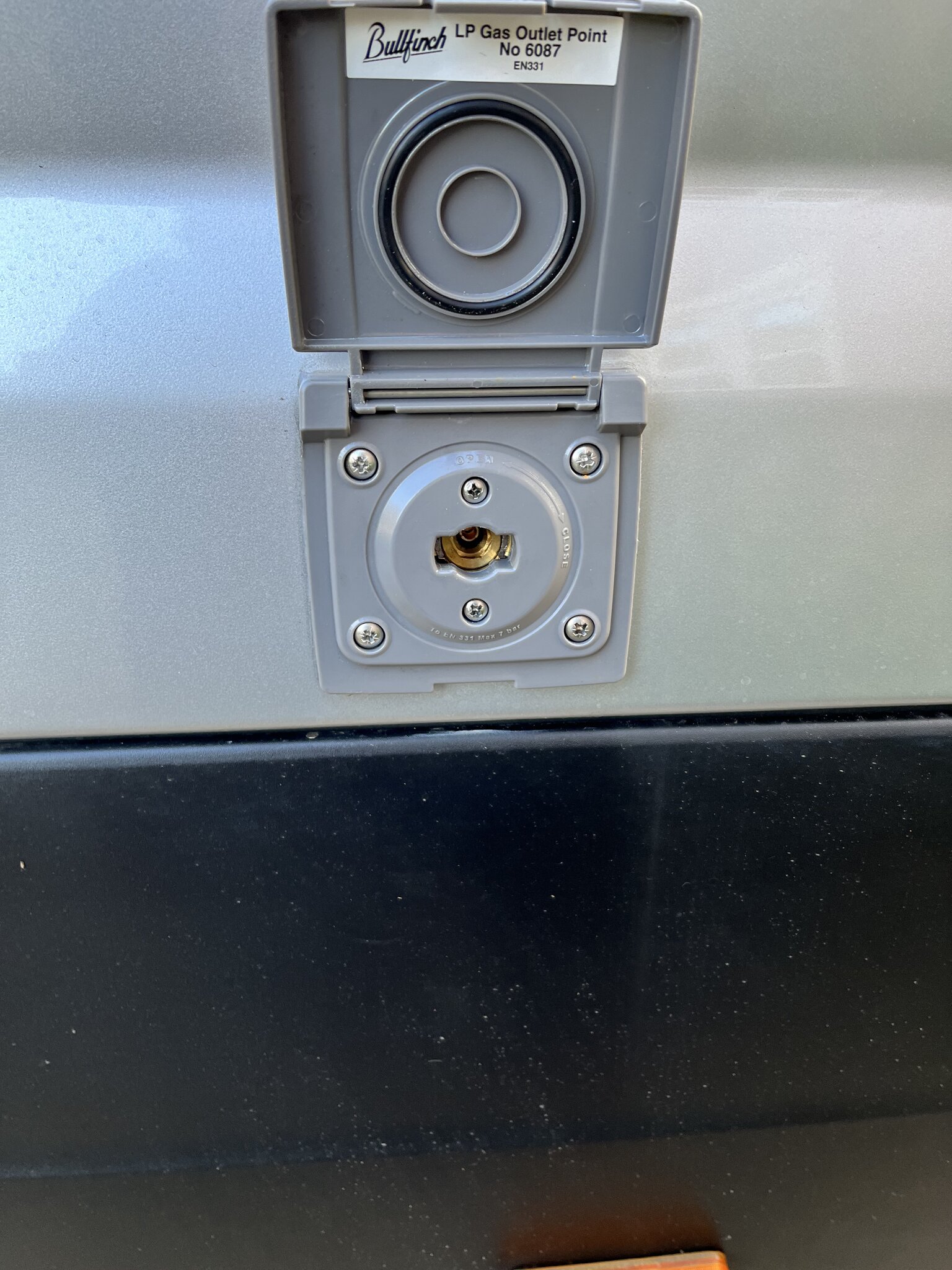

Where's the filler point for your Gaslow?
I fitted a bbq point next to that on ours. It's in the plastic skirt rather than the side of the van itself so nothing to worry about in drilling it.
The round white one is the Gaslow filler and the square grey one is a Bullfinch bbq point.

Another thing to check is there isn’t a shut off tap in line, which I have on mine.
Try and trace the pipe work back to the regulator.
