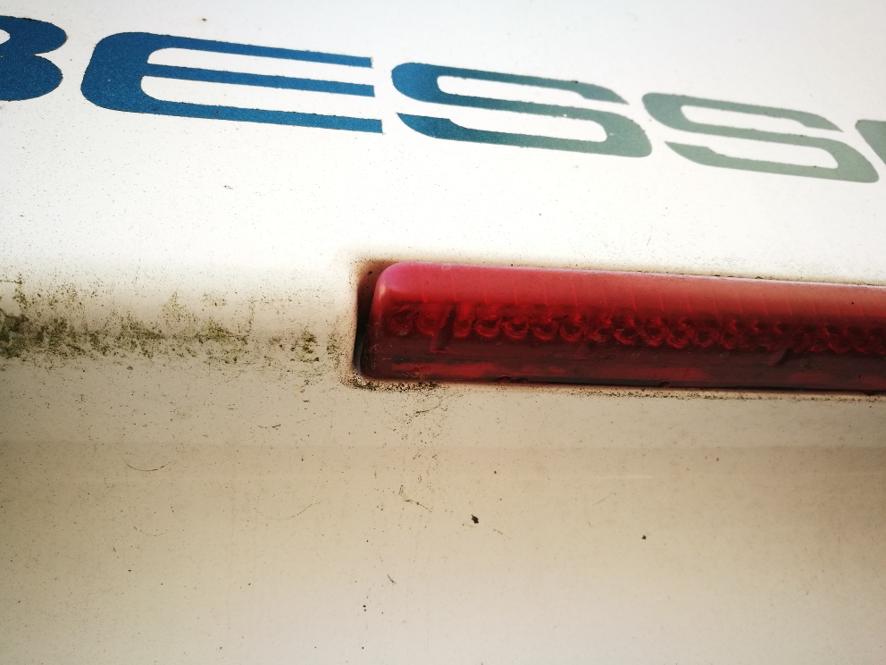

Hi all, thanks for your input, I have managed to get around to take some pictures of the unit, didn’t realise how dirty the van was until I looked at the pics.
Mine was noted as an auxiliary brake light with some light units not working and it went on the mot as an advisory.
Any advice on removing it for repair is appreciated and welcome.

Well at least the manfacturer is still in business, but unfortunately not in the UK but Taiwan !
http://www.leegold.com.tw/third_brake_lights.html
Mine has failed and the garage said they couldn't get it out without destroying it as it was glued in...
they suggested covering it with red tape...:D
