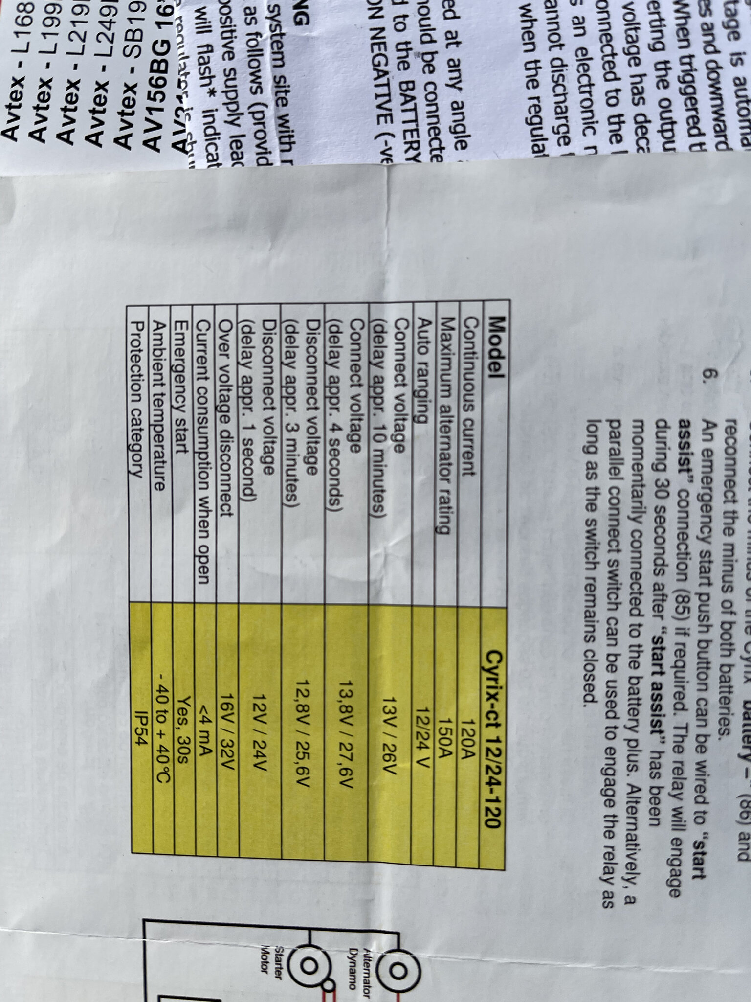

I have the Cyrix ct12/24 intelligent battery combiner. As shown below. Hopefully it’s connected to both the solar and battery charger. Am I right in thinking that it will protect my starter battery provided the solar or mains charger are connected. It’s only off grid that I may experience problems if solar is not sufficient. No need for a battery master?

Yes, I think that one will do what you want, and keep both batteries topped up as required.
Thankyou. I don’t see the point in spending money on a battery master if the cyrix is basically doing the same job. I just wasn’t sure that it was.
