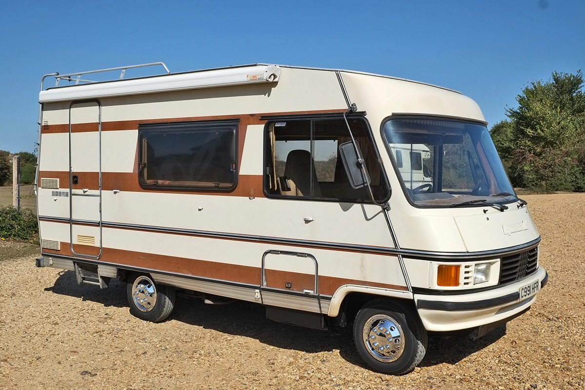

As some of you are aware, we have recently been inflicted with an old Hymer!
It is a 1986 brownie on a fiat 2.5 non turbo base.
We have been working on the interior for the last year or so, and now it's time to get the mechanical side of things done.
It is in need of steering rack, cv joint/bearings, driveshaft and clutch.
The garage we tried have an outside lift for access for larger vehicles, but don't have the right kind of lift to sort these jobs and aren't sure about the availability of spares.... (I know about Coastal motorhomes)
They are making enquiries at local places but have no one that wants to 'take this on'!
We are in Stirling, and the van is driving horribly at the moment, does anyone know of any 'old school' mechanics in Southern Scotland or Northern England that would be happy to do these jobs?
It may involve refurbishment rather than replacement of parts, and even some manufacturing of bits?
Many thanks in anticipation 🤞🏻

Thanks for the info.
The original plan was to trot over to Spain in it and get a lot sorted. We have a mechanic friend next door but one and I know parts are more available than the UK.
Unfortunately the driving is too much of a judder now and from 35 - 55 mph it is a job to hang on to the wheel(driveshaft), also the cv bearing is making such a racket round any r/h corner even at a crawl that I don't want to risk something collapsing or worse. The steering rack needs doing for this next MOT and might as well get the clutch done while it's in bits.....
The rear leaf springs are not quite horizontal yet so they will do 'til we get over and a couple of other bits.
Now we have had the van for a bit, have done most of the interior and are really happy with the layout, we are happy to blow a bit getting it running as it should, and enjoy a good few years motoring.
