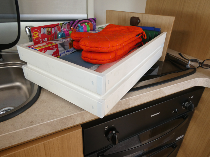

I want to make and fit an internal drawer in the cupboard under our kitchen sink in our Elddis 175 using the same type of drawer construction as the other drawer in our kitchen cabinet, but having scoured the internet I'm struggling to find what I'm looking for in the UK.
Can anyone point me in the right direction please.
This is the modular construction Elddis have used to manufacture the plastic sides of the drawers.
I have found this American made Sheerglide drawer system which looks to be pretty much the same as that used by Elddis, but can not find a UK supplier or a similar product.
https://envorinex.com/sheer-drawers
I understand that Elddis have all their internal motorhome and caravan furniture manufactured in Italy.

It's the drawer box that I want to match the existing, I know I'm a sad bustard, but there you go.
The drawer front is no problem as I bought a panel of the original furniture board a while ago to make a microwave surround to match the housing it's in.

I don't understand the size problem. The plastic sections are a standard joined by corner mouldings. Buy one bigger then shorten to fit?
Which ones are you referring to ?
I thought you had found drawers but the size didn't match. If the depth is OK it's easy to correct the length / width. Your photo looks exactly like the 1960s drawers in my old kitchen.
Yes, reminded me of the same.
I'm a bit surprised not to have found a supplier of the type of drawer construction as it's obviously out there unless the Elddis internal fittings manufacturers in Italy are buying it in from the States.
