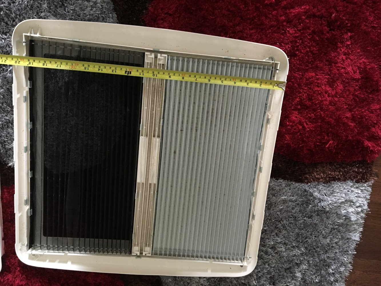

Internal part only of the Heki 400 x 400 rooflight with blind and mozzie net if possible please.
I think we have one. I advertised it a few weeks ago. Let me see ifI can find the pic.[/QUOTE]
Hello @irnbru do you wish to sell the item in your photo?
A plastic lug has broken off - it keeps the cord tensioned and is irreparable thank you.
No it ain't. Replace broken lug with a self tapping screw and re-thread the cord. See YouTube there's a few vids on the subject
