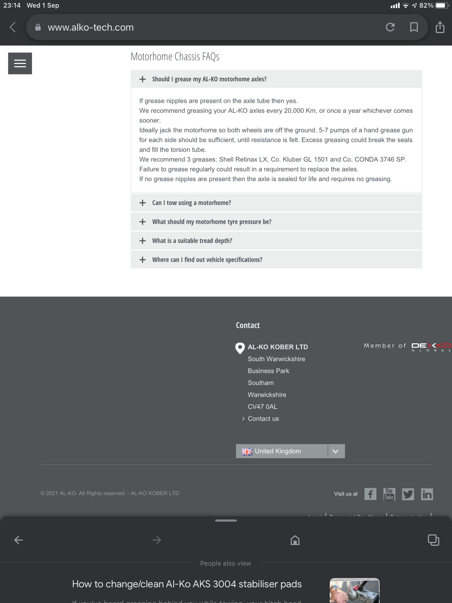

Supposed to be 4 to 5 pumps of the gun, any more danger of pushing the seals out.

From the Alko site:
Axle Maintenance
