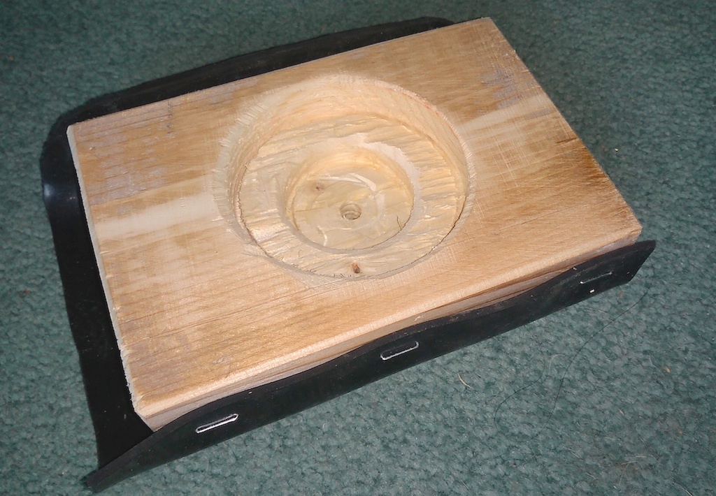

Here's my jacking n tools mod. The wheel jack and tools all came in a giant plastic container from the original van and had nowhere to fit, so I rolled them all up in some bubble-wrap, rested them on a rubber coated bit of wood (the hole/indent stops the jack slipping out) and strapped them into the gas locker.

This is it in place, some velcro straps would be neater to secure the roll but it's nicely in there
