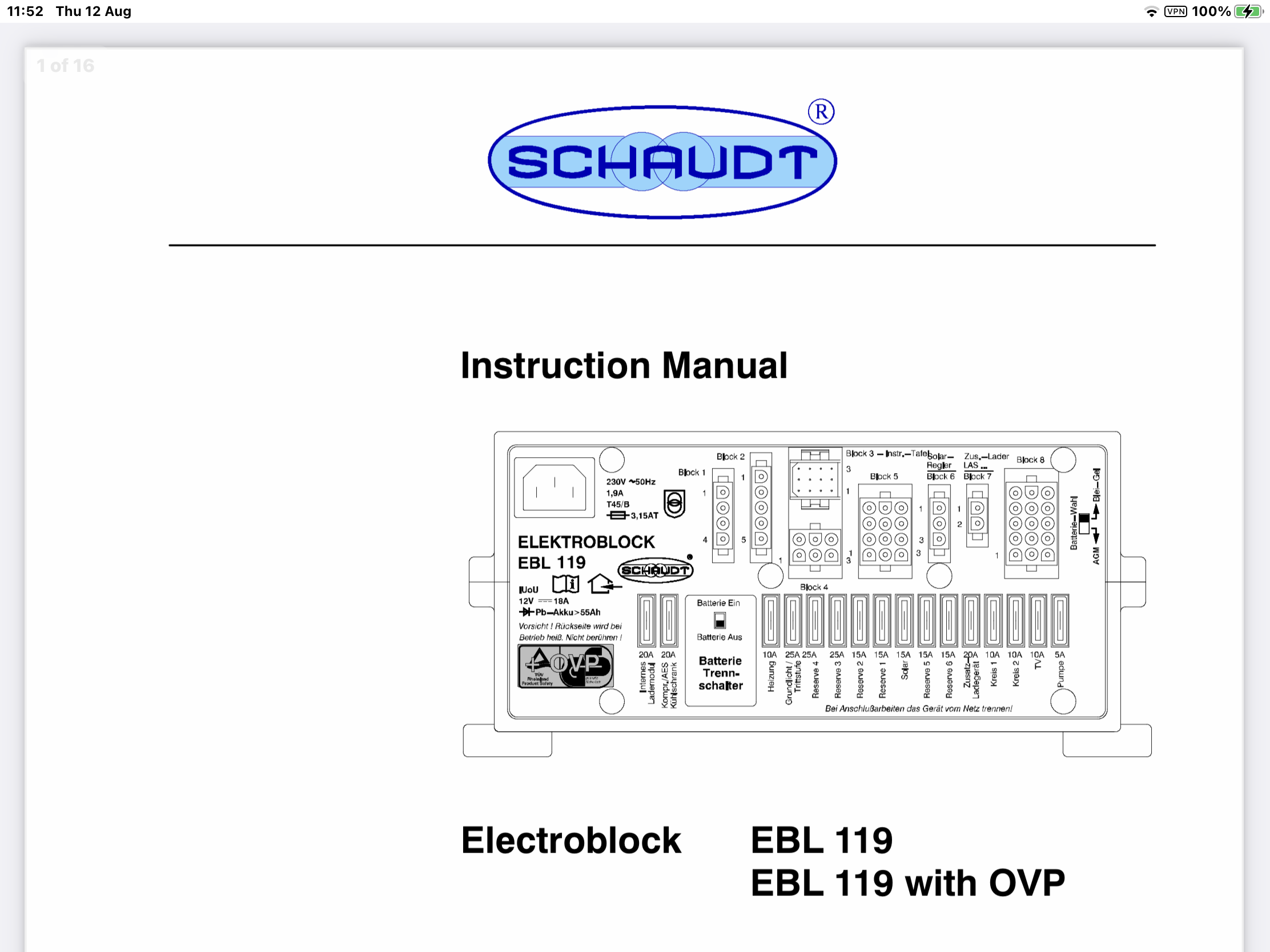

My electroblok charger only has a choice of wet or AGM charging. Can I not fit Gell batteries then?
I've only seen EBL's with Gel/Wet cell or Gel/AGM.
If it is as you say I would say no, the AGM setting will charge to 14.7v too high for Gels and the Wet setting the absorbtion phase may not be long enough to fully charge a Gel.
What model EBL is it?
This is my ebl
Blei-Gel is their term for what we call Gel. Literally Lead-Gel. Standard flooded lead-acid is Blei-saure.
If there's no suitable setting, one option is to disable the built-in charger (pull the 'Internes Lademodul' fuse), and feed another charger into the auxiliary charger 2-way connector (labelled Zusatz Ladegerat). You'll need to fit a fuse into the similarly labelled fuse slot to enable it.
The downside is, you lose the starter battery charging when on EHU.
