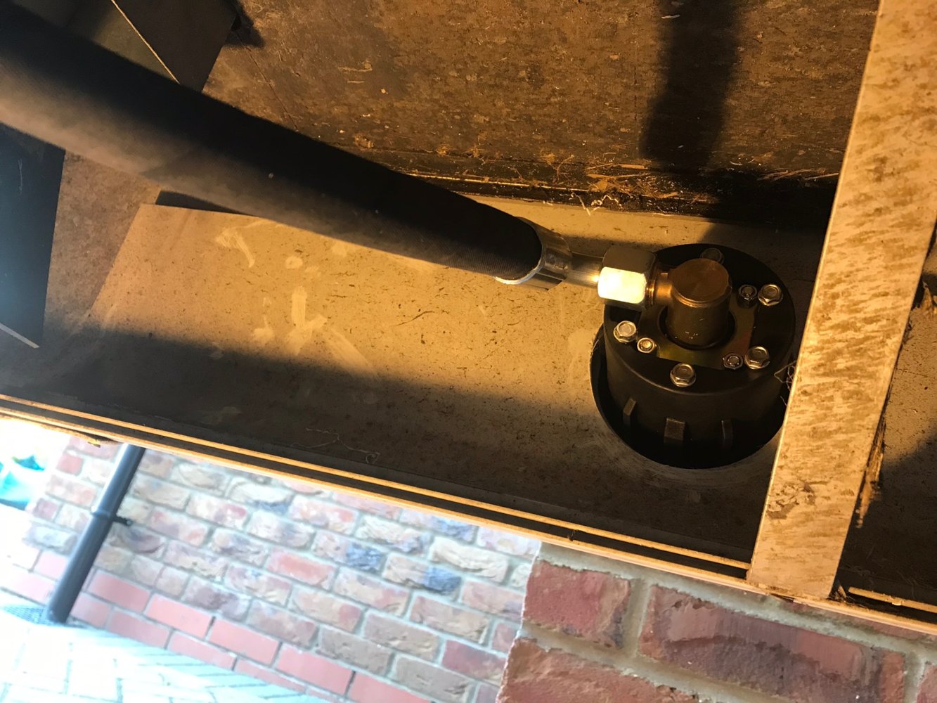

This weekend I have fitted a Gasit twin 6kg refillable system with the external fill point mounted in the skirt, a fairly straightforward job.
Just got to fill the system with the leak spray at the ready lol

Did you make sure the screws holding the filler point don't protrude too much into where the nozzle goes?

Yes I checked that when assembled used small washers to ensure no interference thanks.

Having fitted my own I would recommend a small fill first I filled it to the top then had a small leak no way to empty it
Unless the leak was actually in the cylinder itself you don't need to empty the entire system. There are non return valve seats in both the fill point and the cylinder on the fill connection. Assuming your leak was on a connection of the fill side all you have to empty is the pipework itself to open a joint. Unless there was a faulty fitting or dirt in a mating joint it would probably seal if you gave it another quarter turn, they do have to be very tight joints on the filling pipework.

BA I appreciate your concern the fill test involves just 3 fittings; the first is the fill point and then onto the transfer into the actual bottles which utilise non return valves, I am confident in my ability to fit the system and commission it myself. I will then test each bottle separately for transfer via the regulator to the vans supply. I understand DIY is not for everyone but I enjoy doing it myself, I have recently fitted a Pioneer dedicated Sat Nav system saving £150 on fitting, likewise the Gasit DIY saved me around £200. If you do not see me on the forum again your fears were correct and I will have had a very short retirement.

Thanks I did just nip it up a bit and it was fine. The bloke at gasit said the problem is a slow leak like mine on the fill side the shut off on the cylinder only operates if theres a faster leak (I suspect it might be a very basic shut off device).
