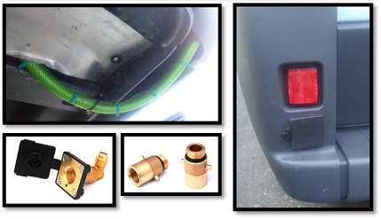

Having fitted our refillable gas system a few times now to different MHs/campers I've found that this is by far the easiest way to fit the filler ... it's taken me longer to compose the below than it would to do it for you!Thats the one..... I like your logic.... I think that definitely a better option than the Gas Door...
You're very welcome. Below is where I put it on our last Globecar PVC, you can see the filler hose on the left (the green snake!) which came out of the bottom of the bumper then up through the gas locker drop vent which was located behind the aluminium protection plate (there was a 8cm or so gap between them so sufficient to get the hose in). The 'green snake' is actually a piece of large bore hose pipe that I cut down lengthways and then cable tied over the filler hose to give it some protection.Ah Wow Mel.... Thats brillant... thank you for that..... I will give it a shot and let you know how much destruction I do...

That's about where I had my filler originally, but it the plastic safety ring on the filler nozzle made it very difficult to connect up. Hence I put the filler on the skirt underneath.Thanks for all the images... Some very clever adaptions... I especially like yours Nixdorfer....
