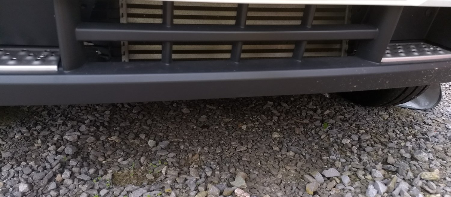

Transit grille before fitting extra mesh - can see the condenser unit in behind:

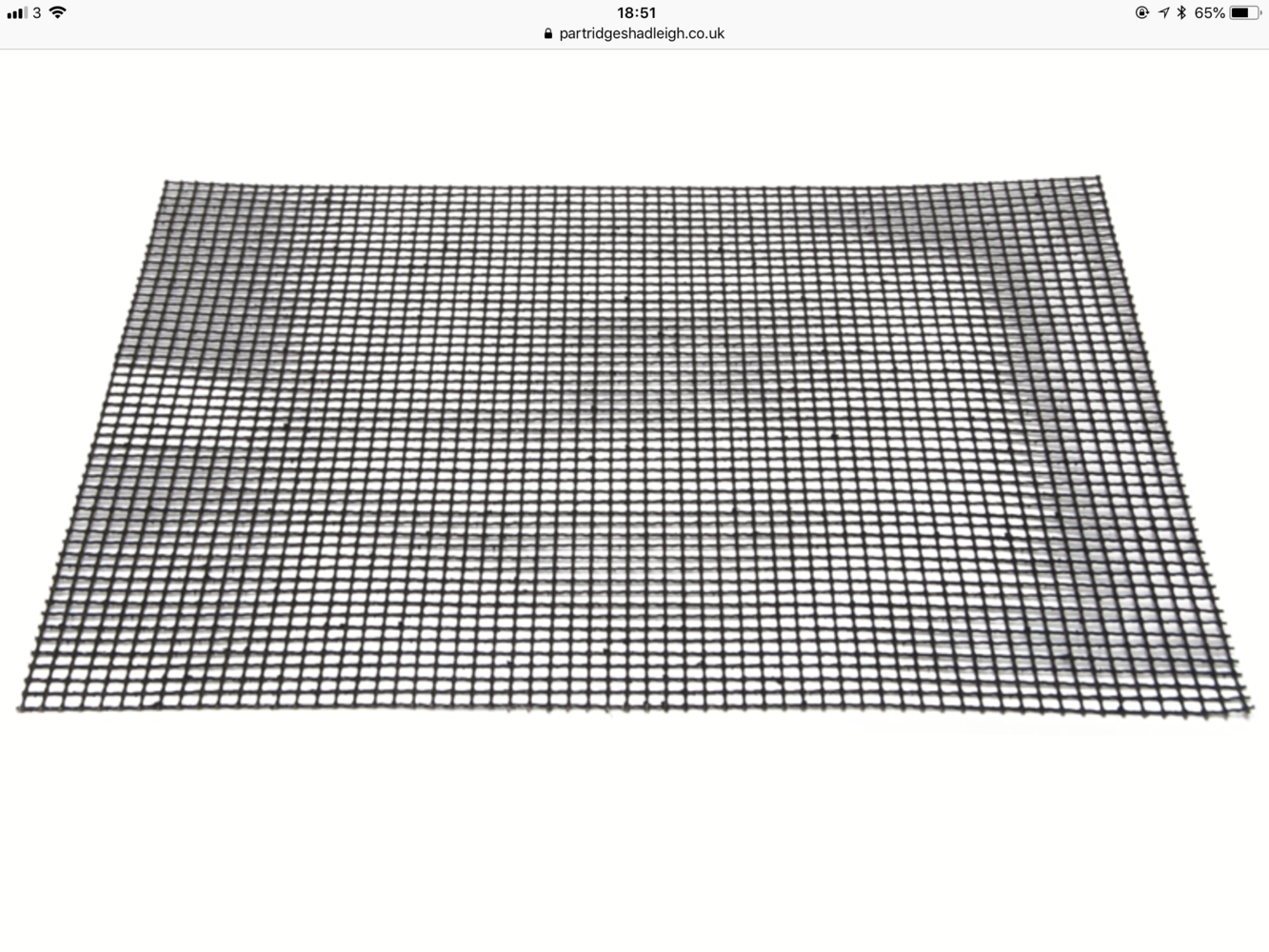

On my autosleeper I simply paid 4 x £0.99 for some black silicone cooking mesh and used a hot glue gun to stick it to the inside of the front. Unobtrusive and cheap. Still there when I sold the vehicle three years later
Interesting budget option but not sure that type of mesh would have stopped the big stone that damaged ours! Difficult to fix anything to the back of some grilles or make it look tidy so the expensive option was the only viable one for our car but at least the DIY stainless steel mesh version worked for the Transit grille (y)
After making a cardboard template - mesh cut to size, ends bent over & ready to cable tie on:
Mesh fitted in behind & cable tied on:
If you cut flush with the horizontals you can avoid the bent over wires effect. A rapid sweep with a grinder or sander will blunt the sharp ends.
The silicone mesh is very tough stuff - it has what looks like Kevlar mesh coated with the silicone. I’m certain that it could take the full force of a large stone at speed.
Mar 23, 2012
9,545
32,089
sleights
20,245
c class
Even if it didn't stop it it would at least reduce the energy it it has no holes in its obviously up to the job!

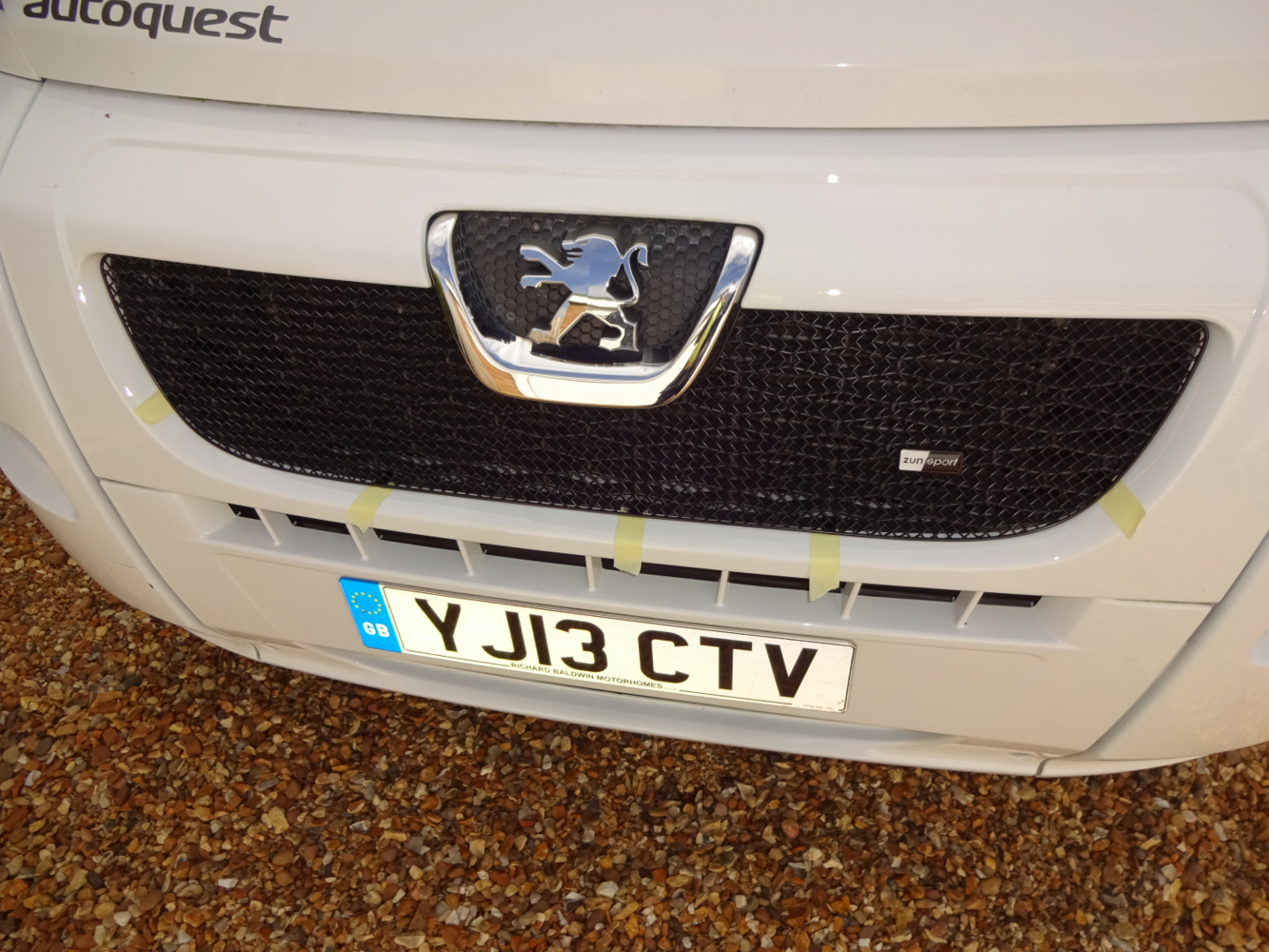

Grille kit now fitted, literally a 15 minute job.
I think I'll pop the centre grille out and paint the area behind it matt black as I'm not keen on the white showing through.
Before
After
As there were no sharp or rough edges on the grilles, I just used masking tape where the clips were.
