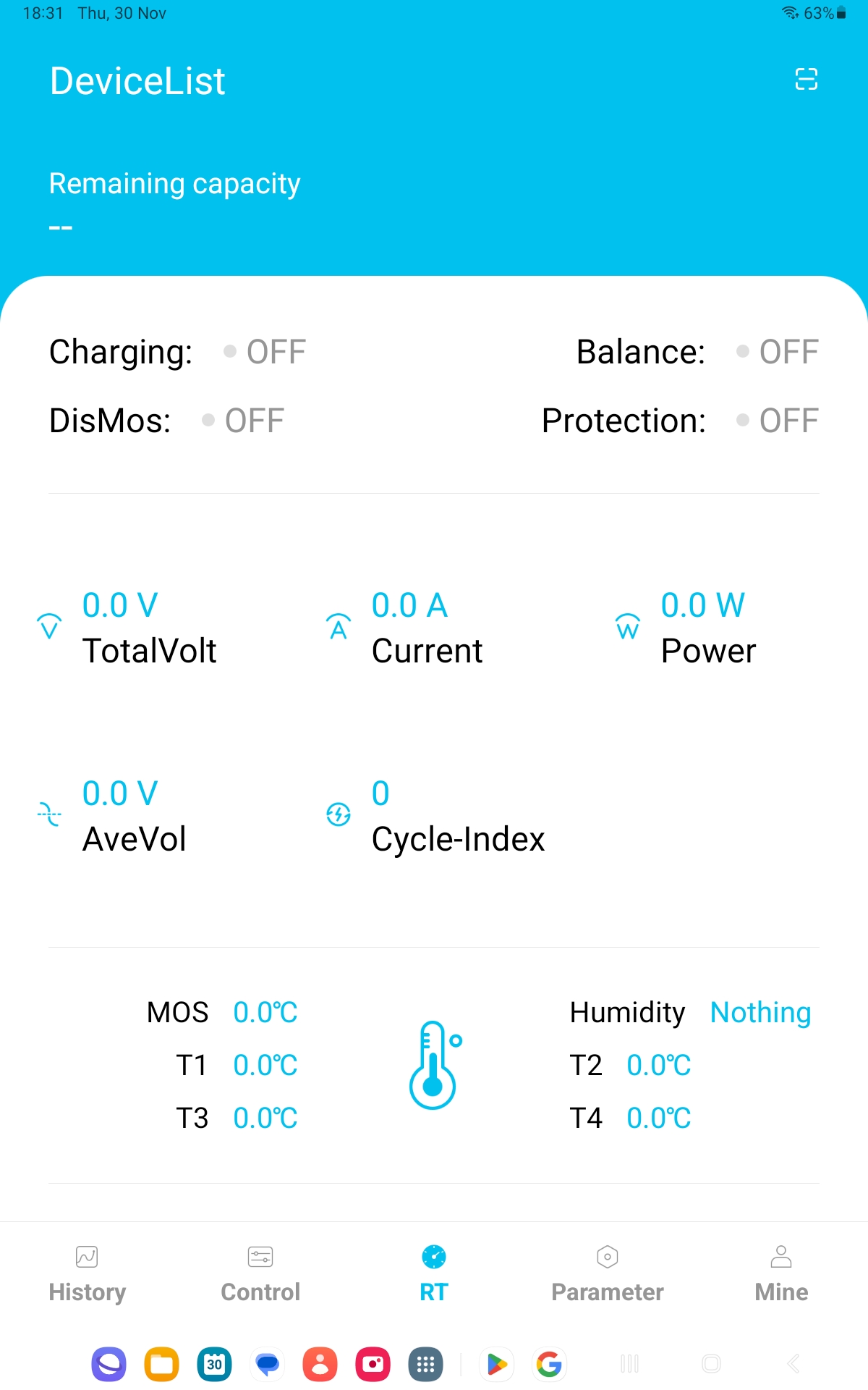

Try connecting with another app such as Xiaoxiang BMS or XiaoXiangElectric (Elephant logo)
Tried that and this is what I got
