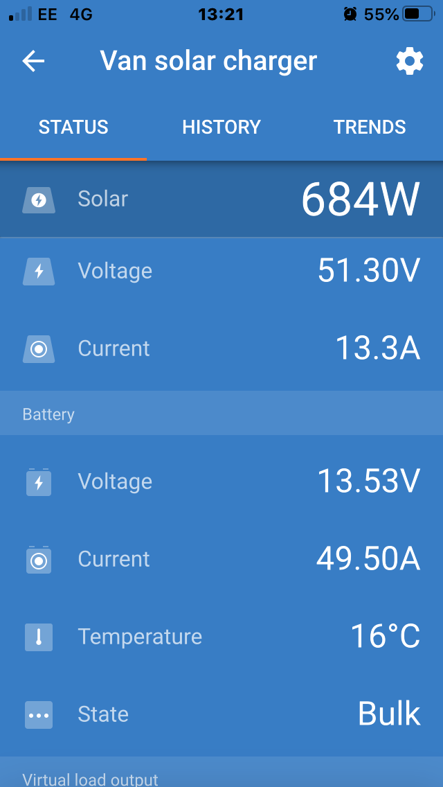

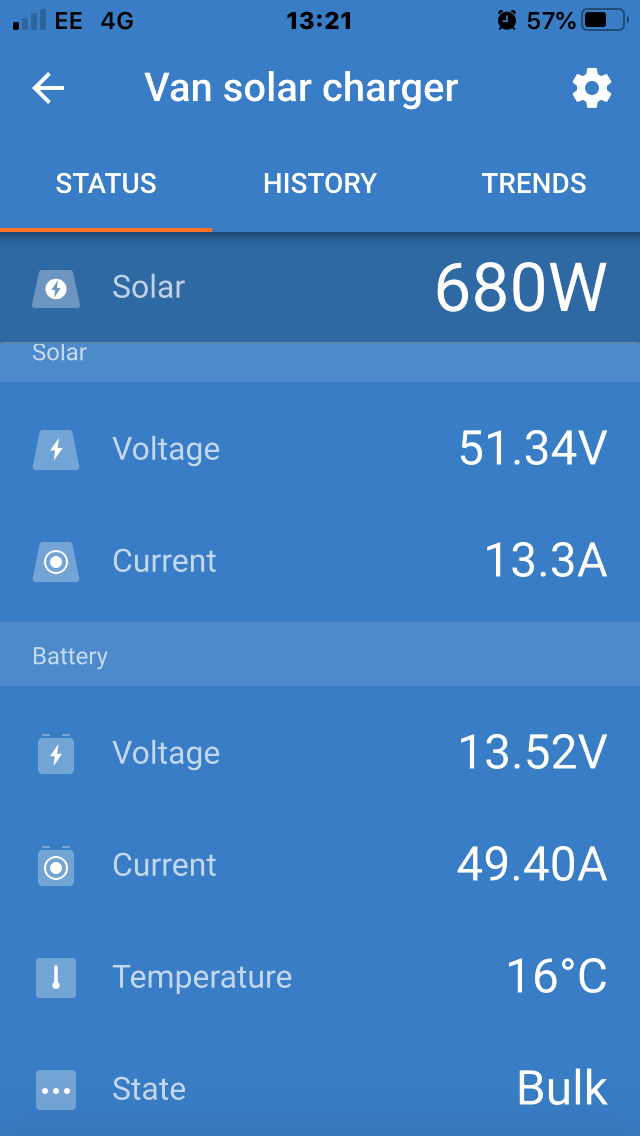

Here is couple of shots of that performance. Victron 100/50, LiFePo4 400ah, and inverter feeding induction hob at the time. Panels are old panasonic N295w compact
I could had more with a bigger controller, the amps from the panel are throttled back by the mppt, as I reach controller limit.
