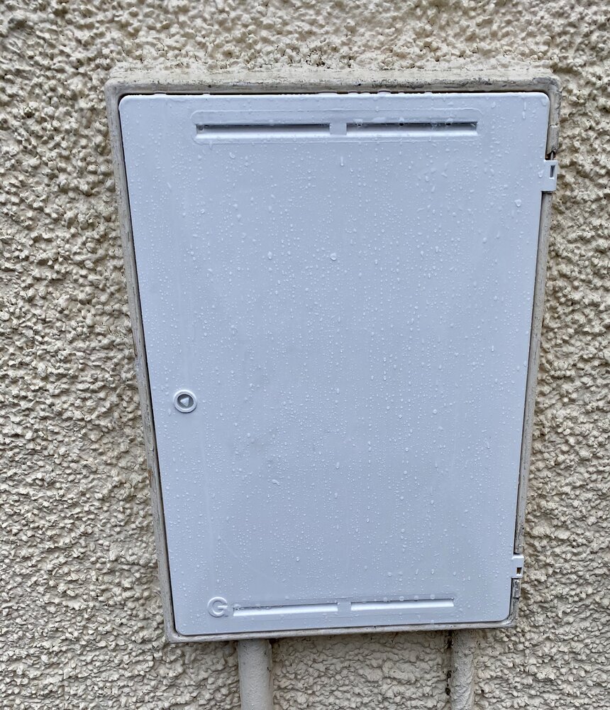

I am pleased to report that the above has been resolved. SGN the company responsible for the gas network could not do a "repair" on the existing box and its door because they couldn't make the hinge pins hold however they did agree to supply a door and a selection of pins for me to "play with" . The new door is literally about a quarter of the weight of the old so there is not such a weight on the hinge pins. There was no additional charge for this. These duly arrived and I have been able to fit the new door after cleaning up the remnants of mastic and duct tape applied by previous owners. The result is per the attached photo. The door seems secure and fits precisely however I may have to build up the shoulder above the top pin and I have bought some fibreglasss putty to do this should it prove necessary.
All in all I am very pleased with the outcome.
