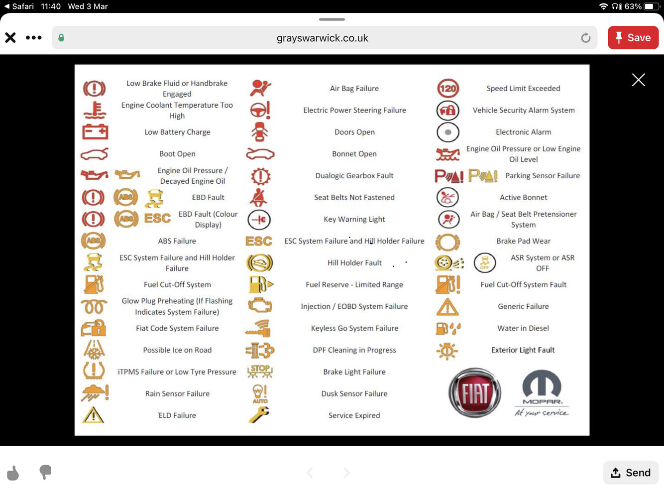

I'm finding it hard to see the symbol in your photo - perhaps you could describe it?
All I have come up with is the ASR as phase3begins suggests.
You are correct, it is the ASR light, the question is can I reset it or is it off to find a dealer ?
