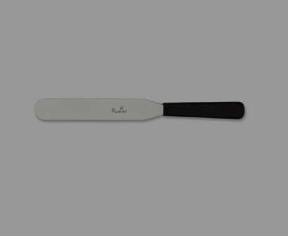

I have the Pioneer unit in a 2015 m/h. Remove the plastic outer frame - it just pops off. Then removed the unit by pushing a pallet knife down each vertical side of the unit to release the side retaining clips - if I remember correctly the clips are in the middle of each side towards the rear end of the unit so you have to push the pallet knife in far enough to release these clips
Then give it a wiggle and it should pull out

FYI I have got the special removal tools that came with the unit but they are too flimsy - not strong enough to release the spring clips - hence the use of the pallet knives.
Here's a picture - of course it's spelt "palette" and not "pallet" as I said wrongly .. oops
