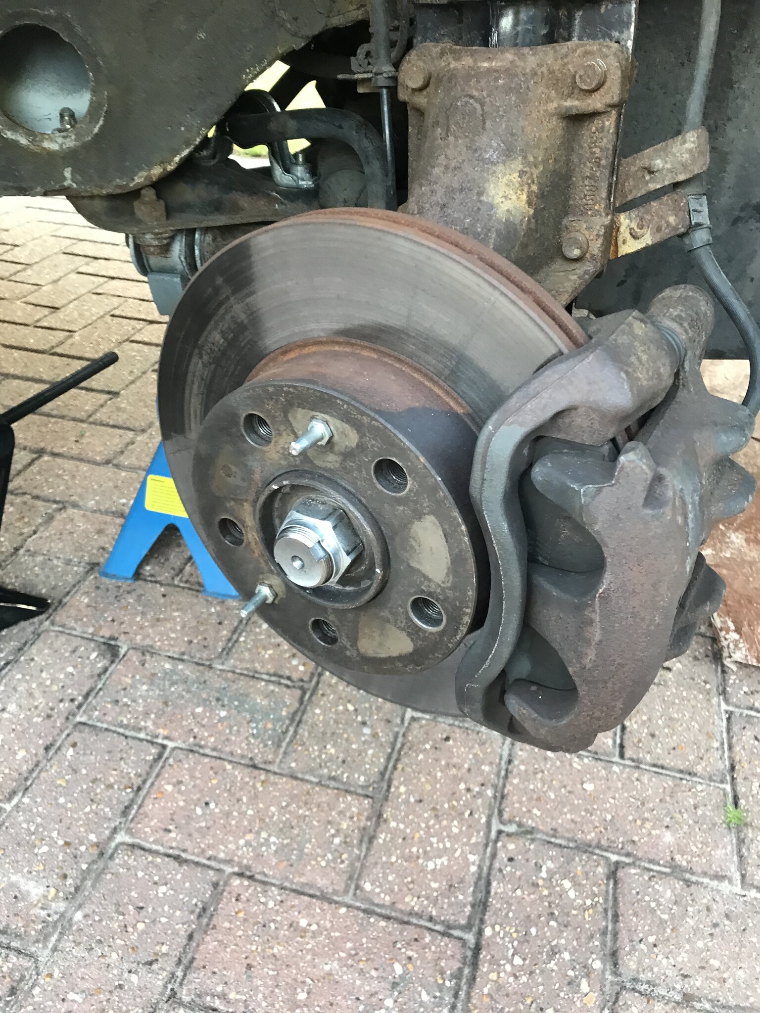

So finally I have got rid of the clunking noise - only took a year 😀
Whilst undertaking a major service including the timing belt, aux belt, gear box oil, oil, filters etc I replaced the R/H side driveshaft and hey presto the noise has now gone - Yipeeeeeeeeee
complete s#@t of a job as the hub nut was seized, nothing would shift it so I used the angle grinder to remove part of the nut. Then the impact driver took it off.
nice and shiny until the next journey
New Hub nut 400nm is the spec for this bad boy 😩
