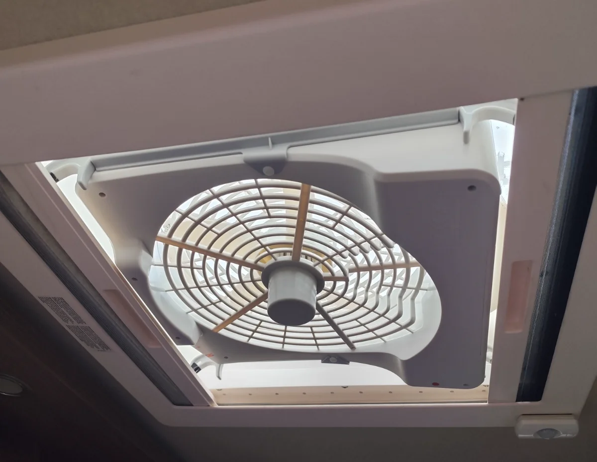

Oh yes it will!!!! That's what I've done! I took some photos for you earlier, they show it sitting with it's 'feet' on the blinds, the blackout one is slightly pulled out to make the gap the correct size, this is in the 'extract mode' hence why you can see the rear of the fan. As I mentioned before I reversed the sprung' legs - it was simply a matter of unscrewing them on either side of the fan and turning them round, being careful to ensure the spring bit stays put (not difficult) - the feet would normally face the front rather than the rear as ours do now. The black gaffer tape on the end of the feet is simply so that it gives some protection to the blinds so the plastic feet can't mark them and so they don't slide about (probably wouldn't anyway but best to be safe). To be fair though you might not have to do the feet change depending on how well the fan fits into your vent/sits on the blinds, possibly the casing itself will 'rest' on the blinds thus negating the need to alter them.
You can see the cable at the side of the fan which is held in place at present with some Velcro to our material lined roof, at some point I'll get round to taking the inner cover off the vent and find the electric cabling that's already there and put a connector on so it will be less 'bodgy' looking. :giggle:

Amazing!! Than you SO much :) Laughing at them saying it can't be done. They obviously haven't accounted for inventive people :) In a few days, we're away with work for 4 weeks so I'm going to get the MH booked in for the replacement skylight for when we get back and also get a Turbo Kit bought.....now I know it'll work :) Thank you for your time in helping me xx
